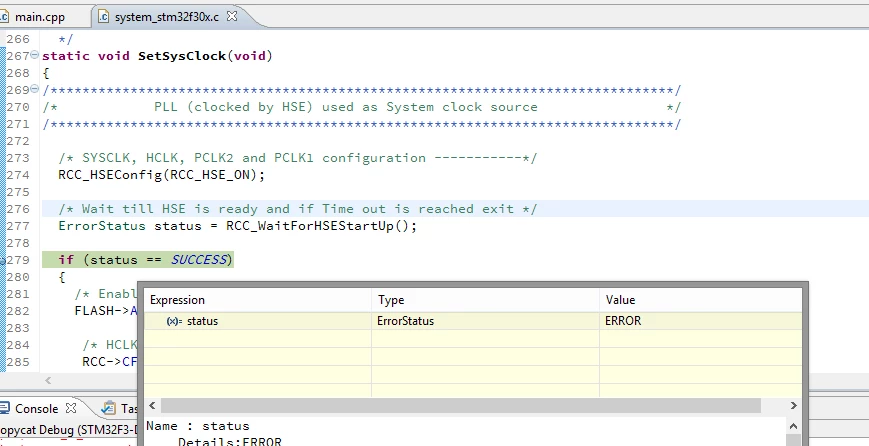

I'm trying to get a STM32F3-Discovery to run on 72 MHz. I have a test project set up
https://github.com/sunsided/stm32f3-disco/tree/hse-problem
. The project is nothing fancy, basically a default project generated from GNU ARM Toolchain for Eclipse.
However, in the
SetSysClock()
code (
https://github.com/sunsided/stm32f3-disco/blob/hse-problem/system/src/cmsis/system_stm32f30x.c&sharpL273-L280
), the loop that waits for the HSE to become ready always times out, so I'm stuck with the 8 MHz internal oscillator.
I tried
RCC_HSEConfig(RCC_HSE_ON)
as well as
RCC_HSEConfig(RCC_HSE_Bypass)
(which I assume is what I need), to no avail. This is on a plain F3-Discovery, i.e. only the 8 MHz osc from the ST-Link, no osc on X2.
Am I doing anything wrong?

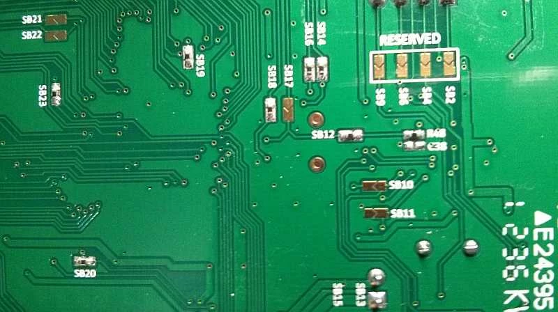

And you have the appropriate SB (solder bridges) configured to connect the 8 MHz signal from the F103 part?
SB12 is OFF by default.
widemeadows
February 21, 2015
Posted on February 21, 2015 at 06:00

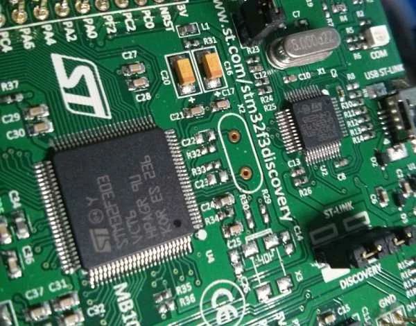

If I understood that correctly, SB12 should be closed, SB17 open and R33 open as well. Should be the case, this is how it looks like on my board:
R32 and R33 appear to be closed in the photo due to perspective, but are open.

widemeadows
February 21, 2015
Posted on February 21, 2015 at 16:21
Humpf ... from what it seems, the R48 resistor is dead.
EDIT: Indeed it was. I replaced the R48 resistor with one I desoldered from an old scanner board and voila, 72 MHz we go. Thanks again!
