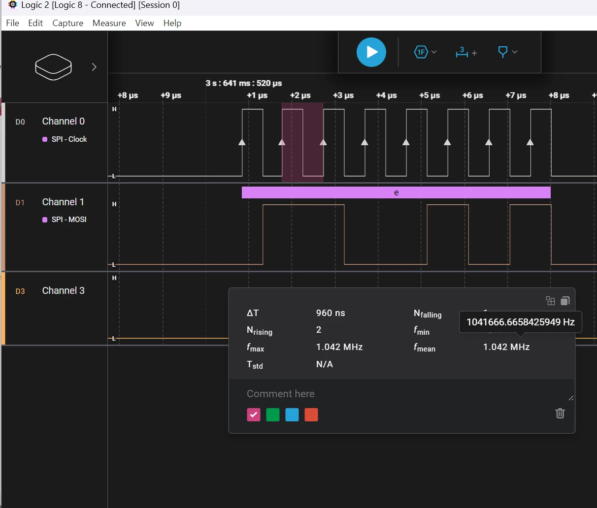

I have set the BR bit in CR1 to 0 with the expectation of obtaining an 8MHz clock frequency. However, I am encountering an actual frequency of approximately 1.042MHz. Does anyone have an explanation for this issue, or should I consider implementing any calibration procedure for the clock?

Default clock (MSI) frequency is 2.097 MHz. Half that is about 1.042 MHz. That is what you're seeing.
Unclear what the current state of this issue is. If you're trying to disable MSI, you will need to switch the system clock to HSI first. Not just turn HSI on, but actually switch the system clock to use it.

Thank you, i'm using STM32L152RE and my clock source of SPI is HSI 16Mhz so if i divide by 2 i will get 8Mhz not 1Mhz.

What are the values of the APB1 Prescaler, APB2 Prescaler and AHB Prescaler on the clock tree.

Thank you i have fixed the issue :grinning_face:
