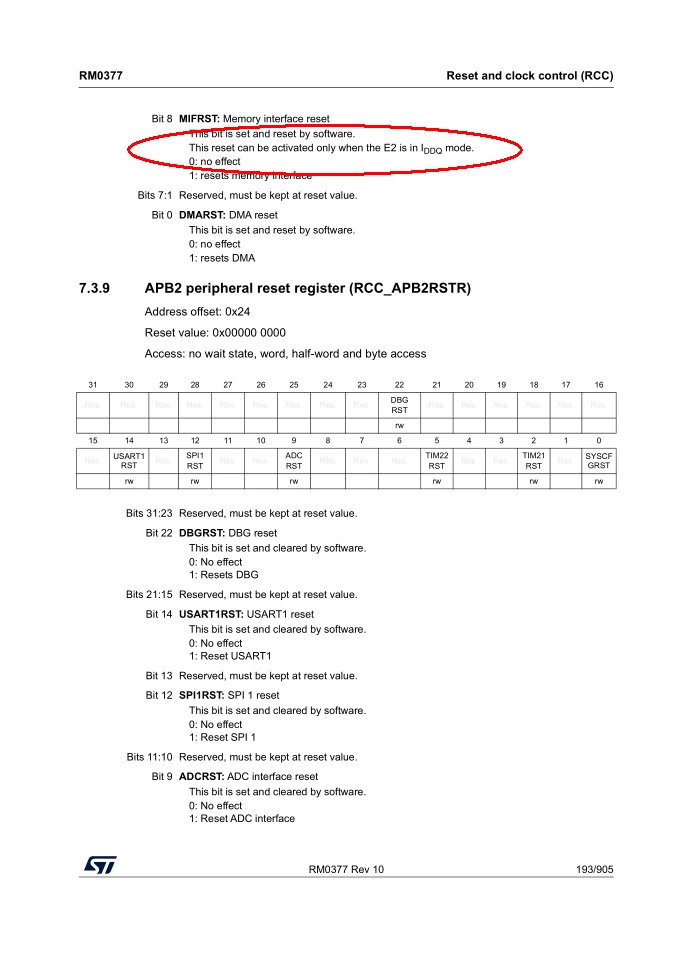

RM0377 MIFRST - what is E2 and what is IDDQ mode?

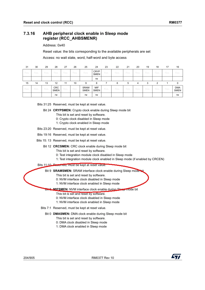

Unrelated, but I don't want to inflate the number of threads: obviously copy/paste error, description of this bit should not talk about NVM:

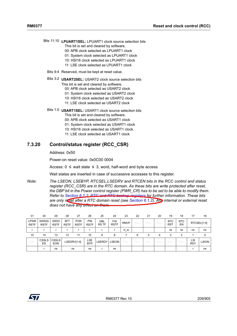

One more, again unrelated:
0693W00000LvcTdQAJ.pngThis is incorrect reference - the backup/RTC domain reset is described in chapter 7.1.3 RTC and backup registers reset .

  • MIFRST bitfield description in RCC_AHBRSTR:
    • Error: E2 and IDDQ are not defined.
    • This will be replaced by "This reset can be activated only when the NVM is in power-down mode."
    • Same sentence will be removed from MIFEN description
  • SRAMSMEN bitfield description in RCC_AHBSMENR:
    • NVM should be replaced by SRAM
  • The note in the description of RCC_CSR:
    • Error: Wrong reference for “RTC domain reset�?
    • It should refer to section 7.1.3 (RTC and backup registers reset) instead of “Section 6.1.2)
