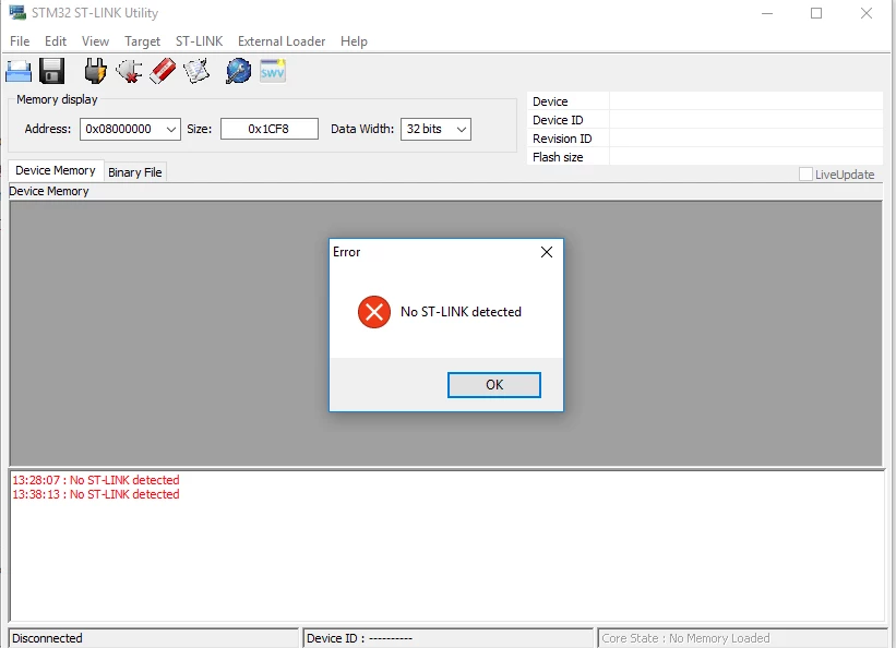

I have a nucleo stm32f401RE board and it has been working fine for the most part.
Here recently, I followed a tutorial in the book ''mastering stm32'', where it said to install openocd. I had been following along
before this as well, and I had been able to connect to my board and flashing it with no problem. After attempting to get openocd to work though, this is no longer possible. Every time i try to connect to my board, I simply get the following error message:
I have not been able to find a solution for this anywhere, so I hope you guys can help! If there is anymore relevant information needed, just let me know.
Thank you very much.

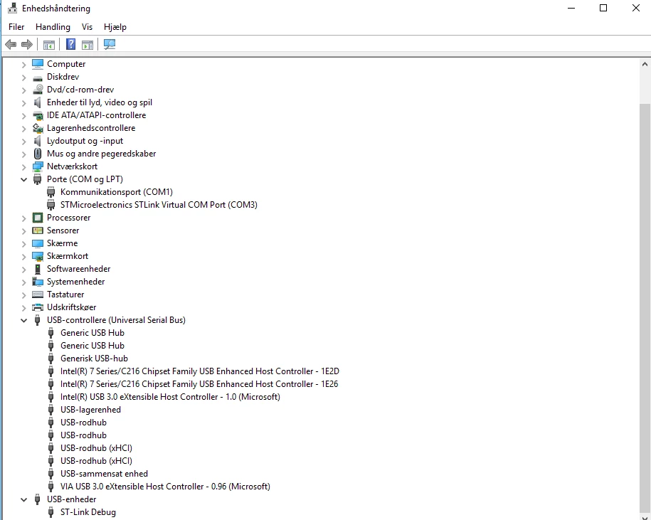

    I?m working on windows 10. I unfortunately don?t know what you mean when referring to witch probe I am using?
    I have already tried to update the drivers multiple times without any luck. Here is a picture of my device manager, which does not seem to contain the ''STMicroelectronics STLink dongle'':

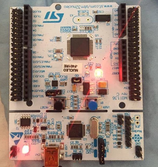

    Also, here is an image of my board, if that can give any clearance:
    Thanks

    ok kristian

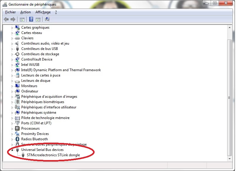

    the board you are using is including a STLink dongle the small part where you usb plug is (witch I call also probe sorry it's a direct translation of french word and may be not accurate) you can use it also for flash other boards but here it looks binded to the nucelo as describe here
    http://www.st.com/content/ccc/resource/technical/document/technical_note/group0/30/c8/1d/0f/15/62/46/ef/DM00290229/files/DM00290229.pdf/jcr:content/translations/en.DM00290229.pdf
    anyway i think it's well known by windows under 'st link debug'
    I sugest you to upgrade your probe (I checked it's the right word ) firmware by using this
    http://www.st.com/content/st_com/en/products/embedded-software/development-tool-software/stsw-link007.html
    (requiring a power off/on of your probe)
    and check your board documentation about the 2 jumpers on the right side of usb plug
    remember me why you have installed openocd ?? what EDI are you using ??

    Hello Kristian,
    from your photo above it's clear that the jumpers on ur nucleo are correct, so it's very strange that the 'probe' could be bricked like that. (i call it a 'loader' since it is more often used just to load your program into the microController chip). the reason the nucleo board has slots in it is so that the loader part of the board can optionally be broken off once the uC has been programmed. But whether you separate it or not, it can be used independently of the main part of the board (by changing the jumpers) as a 'dongle' to program other stm devices or boards.
    i've had the 'no st-link detected' when using the ST-Link Upgrade utility to upgrade my ST-Link dongle and usually got it working just by unpluging and repluging the device. But not always. i've had frequent problems with faulty usb cables.
    maybe if you post the document you're using we can find what's wrong.
