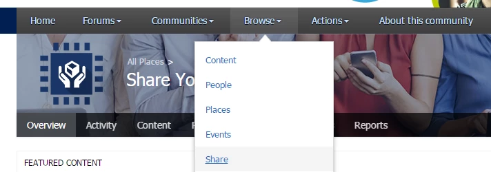

    https://community.st.com/community/share-your-activities/blog/2016/12/04/how-to-share-your-activities-with-the-community
    You can share your project in the community by clicking onBrowse >> Share >> Share your project (in the right)

    Imen,
    Thanks for the documentation on how to share. I have shared a .zip of the project with the community.
    https://community.st.com/0D50X00009bMM5YSAW
