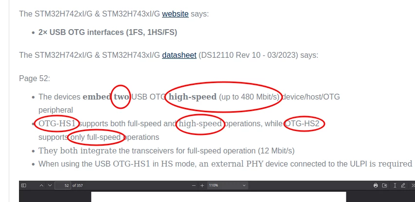

The STM32H742xI/G & STM32H743xI/G website says:
  • 2× USB OTG interfaces (1FS, 1HS/FS)

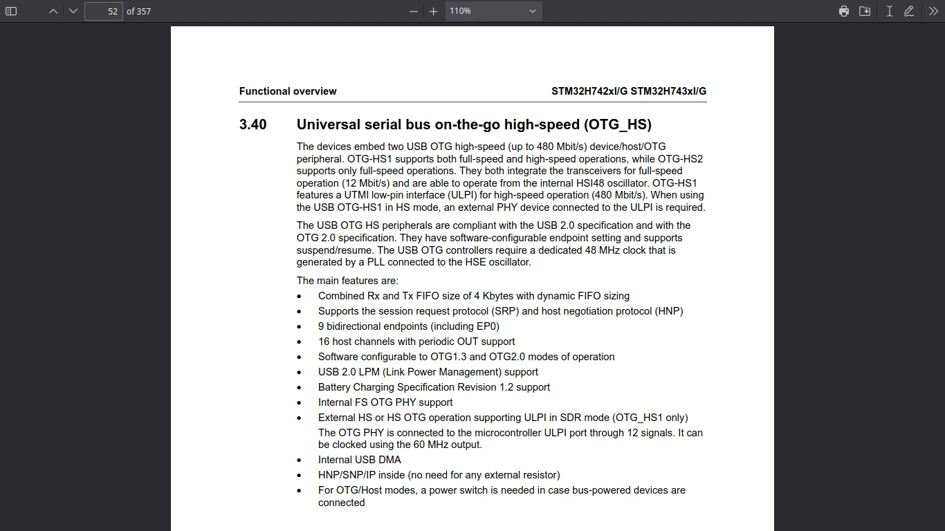

The STM32H742xI/G & STM32H743xI/G datasheet (DS12110 Rev 10 - 03/2023) says:
Page 52:
  • The devices embed two USB OTG high-speed (up to 480 Mbit/s) device/host/OTG
    peripheral
  • OTG-HS1 supports both full-speed and high-speed operations, while OTG-HS2
    supports only full-speed operations
  • They both integrate the transceivers for full-speed operation (12 Mbit/s)
  • When using the USB OTG-HS1 in HS mode, an external PHY device connected to the ULPI is required

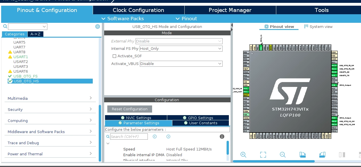

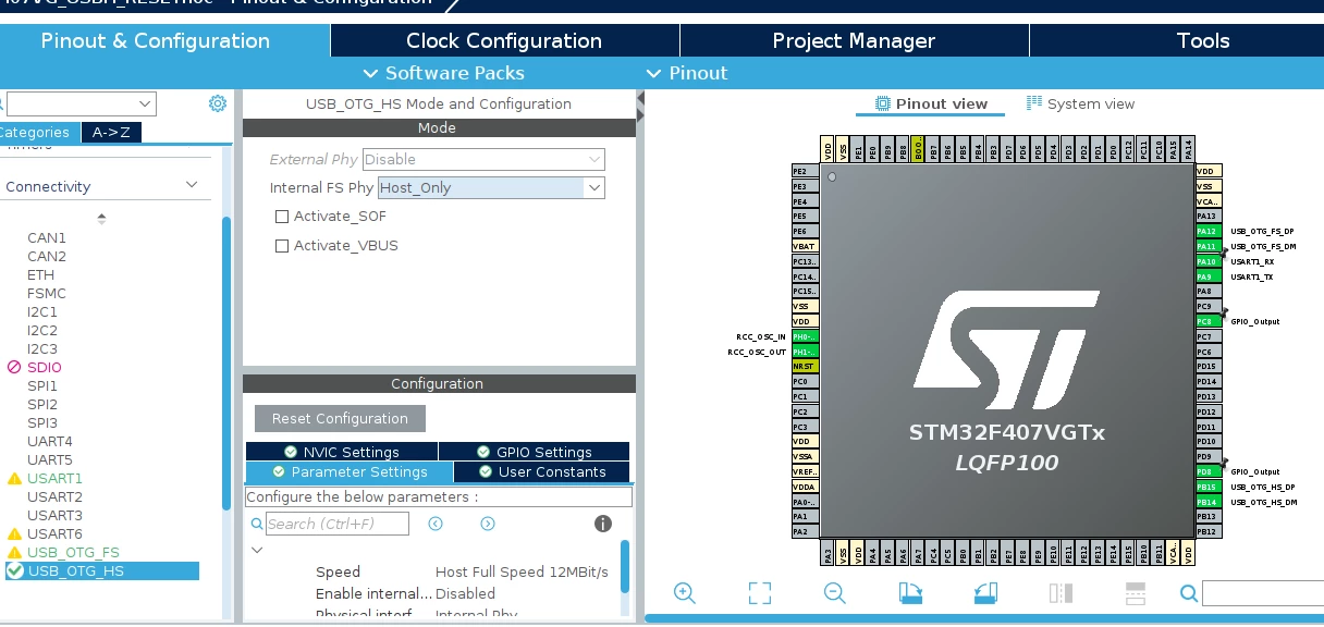

The STM32CubeIDE shows pretty much the same settings for the H743 MCU as it does for the F407:

ds say, there is hi and full speed usb module (on some H7) ; full speed has internal phy, hi speed needs external phy.
again:
...and where is the error now ?
ed.
ah, i see: on p.52 >two usb hi-speed ..< . thats wrong, ok. should be : >two usb hi- or full-speed ..<
waclawek.jan
June 18, 2023
The OTG markings are notoriously inconsistent throughout ST's documentation,  they differ even within documents to one model.
I am not defending it, it's bad, and in this particular case it's incorrect.
I call "HS USB capable only of FS" a marketing lie.
