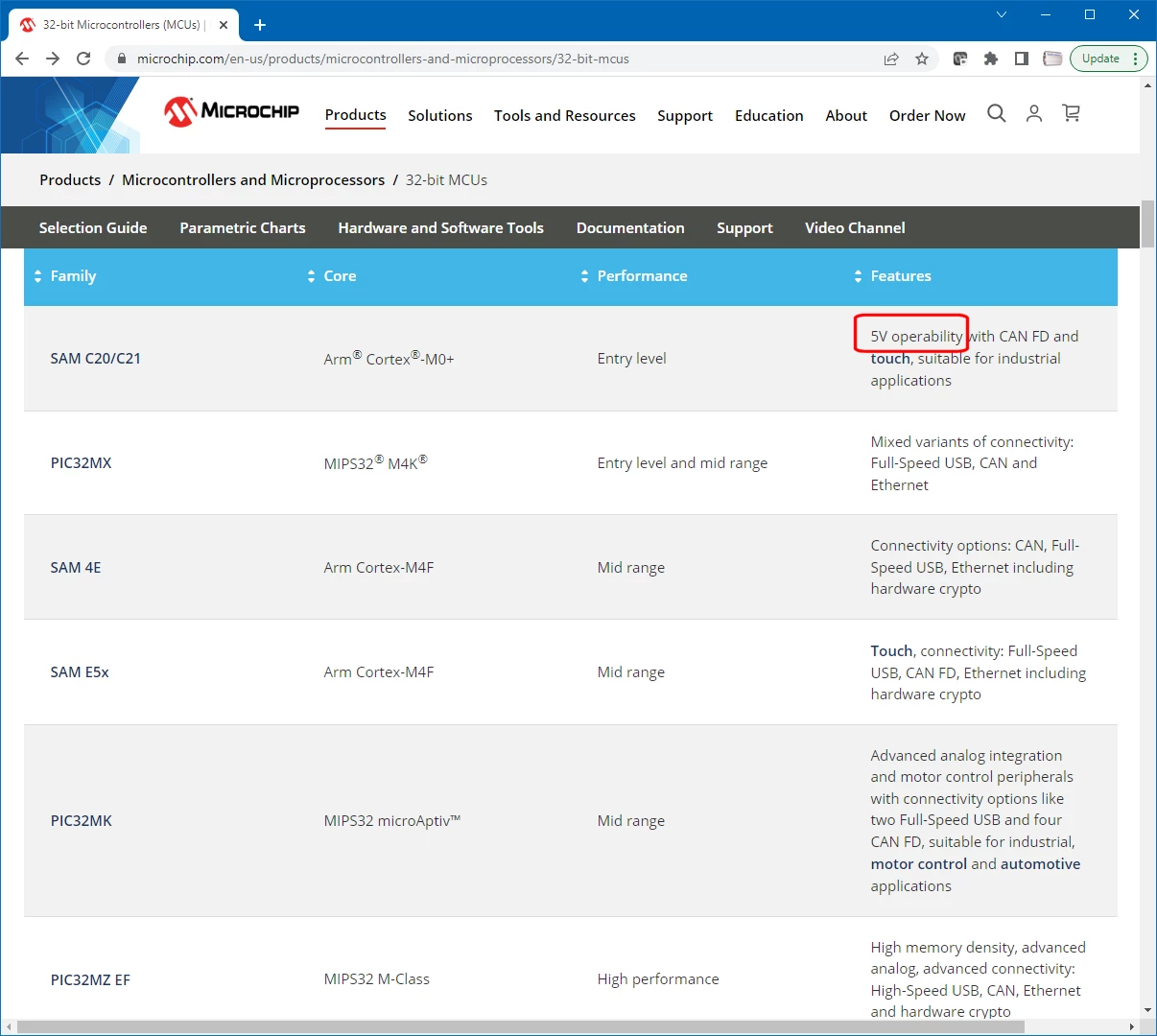

@NDesh.2​ "generally manufacture like ATMEL produces same uC with variants who works on 3.3V & 5V"
Actually, they don't - very few manufacturers have 5V Cortex-M microcontrollers.
IIRC, Microchip (formerly Atmel) has only one?
EDIT:

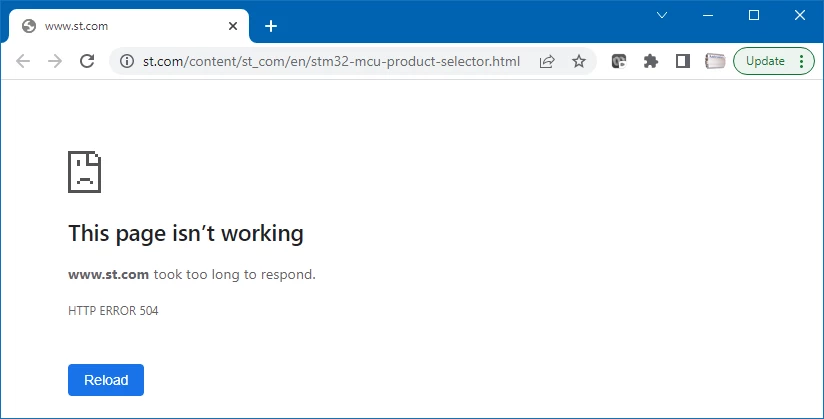

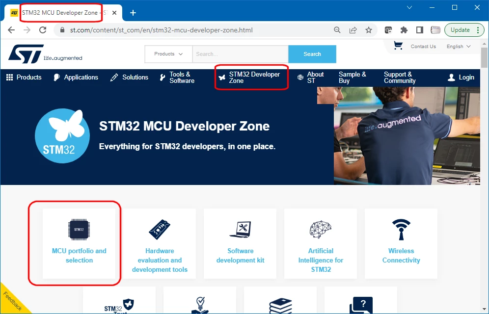

Have you tried the "STM32 Finder new mobile app" ?
https://www.st.com/en/microcontrollers-microprocessors/stm32-32-bit-arm-cortex-mcus.html#st-highlight-promotion
EDIT
Or the Product Selector?
Although that seems to be broken at the moment:
Amel NASRI
Technical Moderator
July 18, 2022
Hi @Andrew Neil​ ,
Do you still have the issue with "MCU portfolio and selection" please?
There is no such issue on my side.
-Amel
