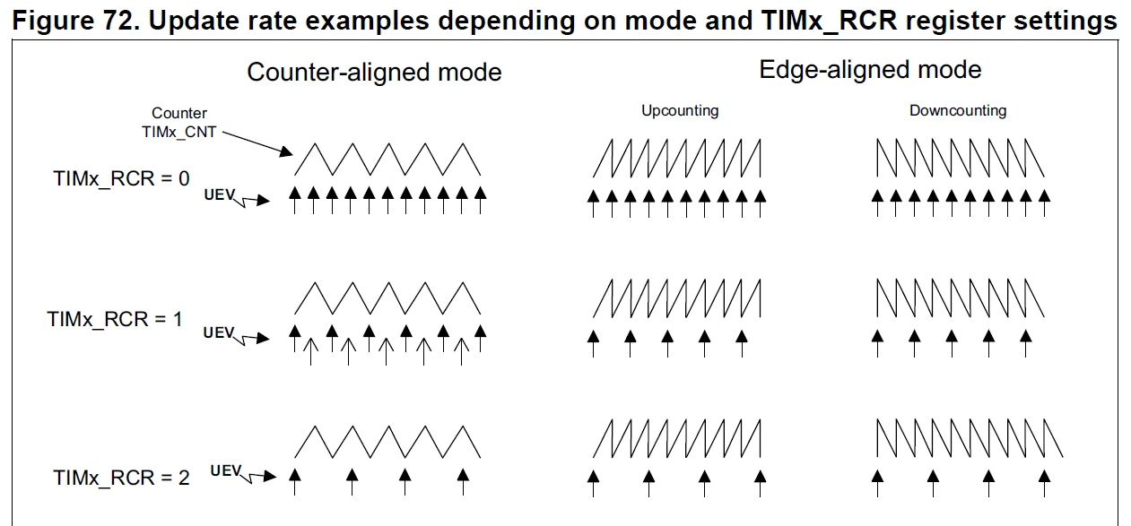

Is it possible to have interrupt (TIM1_UP_TIM16) fire only once per cycle in centre aligned mode ?
I am using STM32F100RBTx device present on STM32VLDISCOVERY board.
I am using TIM1 with the configuration listed below. Please note that this is a partial config, other channel and clock related settings are irrelavant to interrupt so I havent posted.
cr1.ckd = 0;
cr1.arpe = 1;
cr1.cms = 2;
cr1.urs = 1;
dier.uie = true;
Interrupt vector : TIM1_UP_TIM16
With this I am able to generate centre aligned PWM waveforms with proper duty and frequency, but the interrupt is triggered twice in each cycle, one when the CNT is 0 and one when CNT = ARR. I want the interrupt to be triggered only once, when CNT = 0. Is it possible to do that ?
With cr1.cms = 2 and TIM1_CC interrupt, the interrupt will trigger only once in a cycle, but that time I cannot update CCR. My limitation is I can only udpate CCR when CNT is 0, and I cannot afford interrupt firing again at CNT = ARR (CNT = ARR is irrelavant as nothing is done at this event), due to performance degradation. Please help.
No, this is how the Update interrupt behaves in the centre-aligned modes.
Set up a *different* channel of the same timer to output compare, without actually mapping it onto a pin; set its CCRx = 0 and enable interrupt on that channel.

Thanks for the clear answer and also for the alternative. I believe that should solve my problem.
May 9, 2021 2:19 PM UTC
If the timer has one (which TIM1 does) you can set RCR to 1 to get an update event/interrupt on 0 but not ARR.

Your suggestion also works, thanks a lot !!
