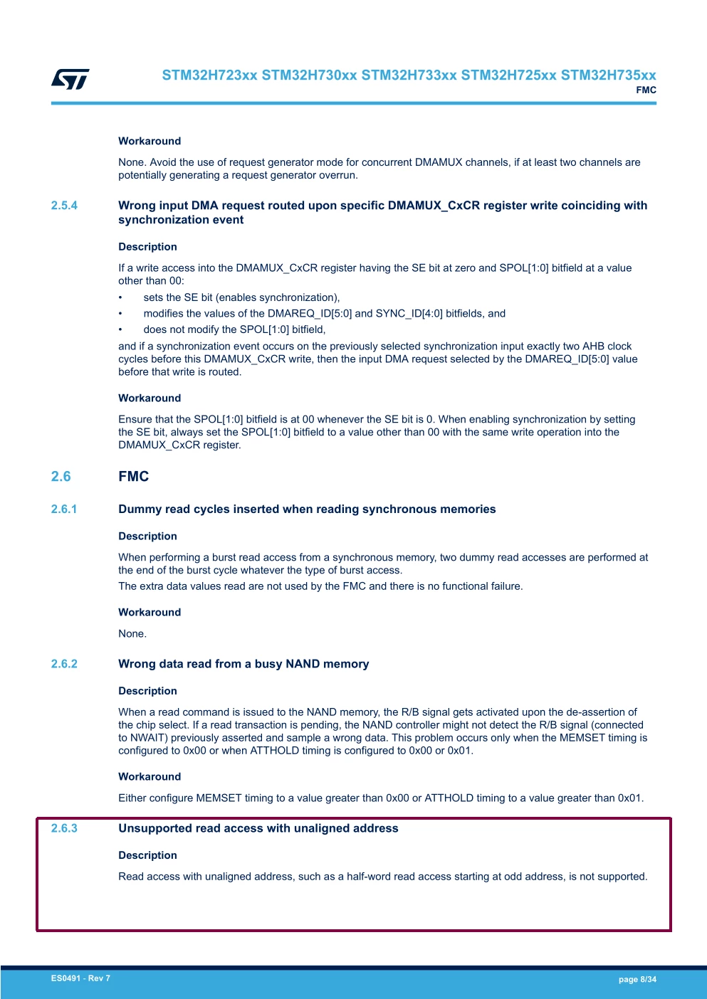

waclawek.jan
March 25, 2023
0693W00000aJh9IQAS.pngThat you were able to perform some unaligned accesses, may be coincidental.

waclawek.jan
April 21, 2023
Did this piece of information come from @Douglas MILLER​ ?
How does this match the erratum above? I understand that cache fills/evictions may be always aligned, but is there a guarantee for that by the cache/processor?
