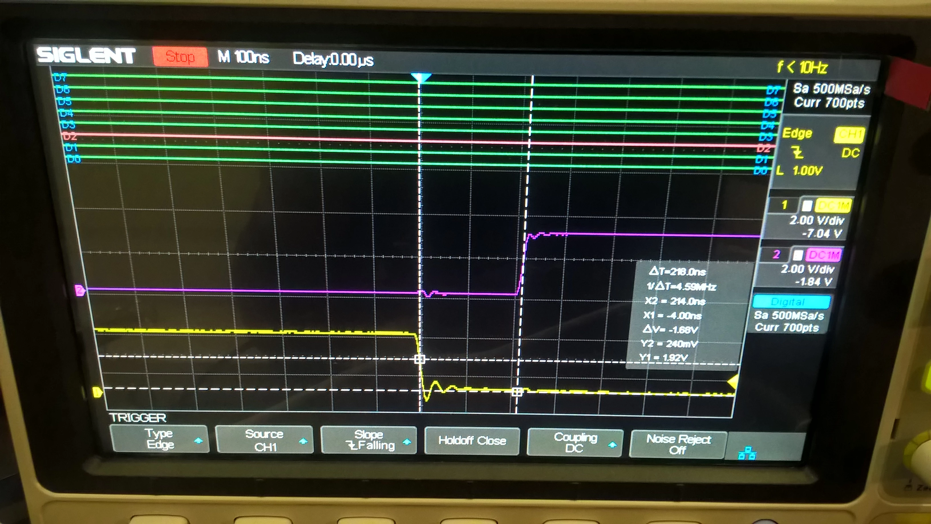

Hans T
Hans TAuthor
Dec 14, 2016 4:49 PM UTC
Posted on December 14, 2016 at 16:49
Hello Lawliet
The same configuration I mean the test, see scoop image.
Yellow channel is the chip select connected to the PC0 of the STM
The PCO is configured as ''Interrupt Mode Ecternal widh trigger Falling edge detection''
Purple channel is the PG13 standard GPIO output (High speed) GPIOG-> = BSRR GPIO_PIN_13.;
Very simlpe test.
The question remains, What is the reason the stm32f767 That Has A higher response time Compared to the stm32f429 ??

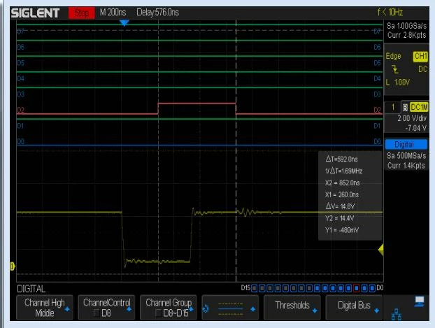

Hans T
Hans TAuthor
Dec 15, 2016 4:02 PM UTC
Posted on December 15, 2016 at 16:02
200ns
Seems
like a
long time
but
don't
shy
the
IRQHandler
is
592ns
* @brief This function handles EXTI line0 interrupt.
  @brief Interrupt SLTSL RD/CS1  4000-8000
void EXTI0_IRQHandler(void)
 GPIOD->BSRR = TestP2;
 HAL_GPIO_EXTI_IRQHandler(GPIO_PIN_0);
 GPIOD->BSRR = TestP2<<16;
Yellow       = interrupt  falling edge  pin pc0
D2            = GPIOD TestP2
