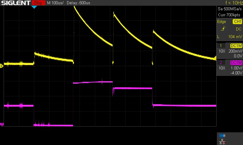

After "resetting" PA1 to zero (by setting it to output momentarily) and setting voltage on PA3, are two modes: a single ADC sequence followed by a delay, resulting in a peak and decay on PA1 (yellow CH1 - PA1, 200mV/div, purple CH2 - 1V/div)

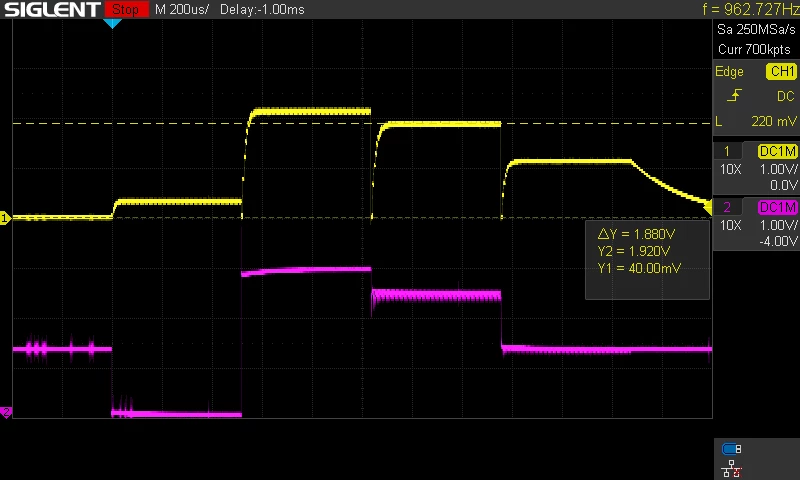

and repeated ADC sequences resulting in voltage on PA1 increasing to a certain steady level (yellow CH1 - PA1, 1V/div, purple CH2 - 1V/div):

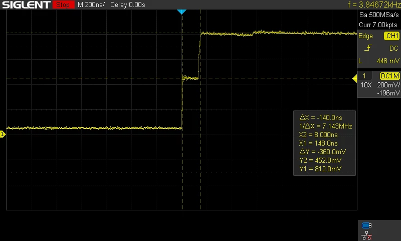

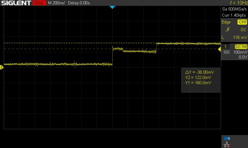

There are also some details which may or may not indicate that the underlying processes are somewhat more compliated. For example, with 0V on PA3, while the "single pulse" voltage achieved around 0.15V, the converted value was equivalent of cca half of that. Also, details on the "single pulse" conversion (200ns per div, ADC runs on default 16MHz HSI and default 3 cycle sampling, i.e. sampling duration is cca 188ns, conversion is 12 cycles i.e. 562ns) are interesting and suggest that part of the observed voltage increase happens at the beginning of the sampling cycle and part at the end (maybe half cycle before end?), with another voltage step at the end of conversion. First PA1 waveform is for PA3=0V, second is for PA3=VDD=2.9V:
