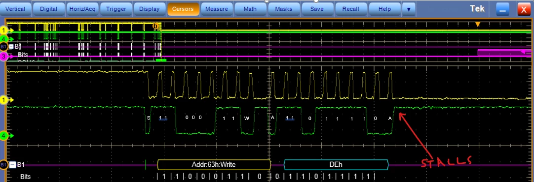

Hi Pavel, we've just encountered an I2C/DMA issue with our STM32H743. It transmits the address and the first data byte successfully (both acked), but fails to transmit the 2nd data byte. There is no error generated and the i2c clock remains low. The driver waits indefinitely for the transmission to complete (which it never does). We've found some boards are more susceptible to the issue than others. A screenshot of the i2c stalling is attached.
The ratio of our i2c clock to APB clock is in range specified by the STM32H72x errata, so we are also wondering if it was incorrectly excluded from the STM32H743 errata. We're changing the clock ratio and will let you know if it fixes the issue.

Pavel A.
Pavel A.Author
September 15, 2022
David, thanks for sharing your case.
