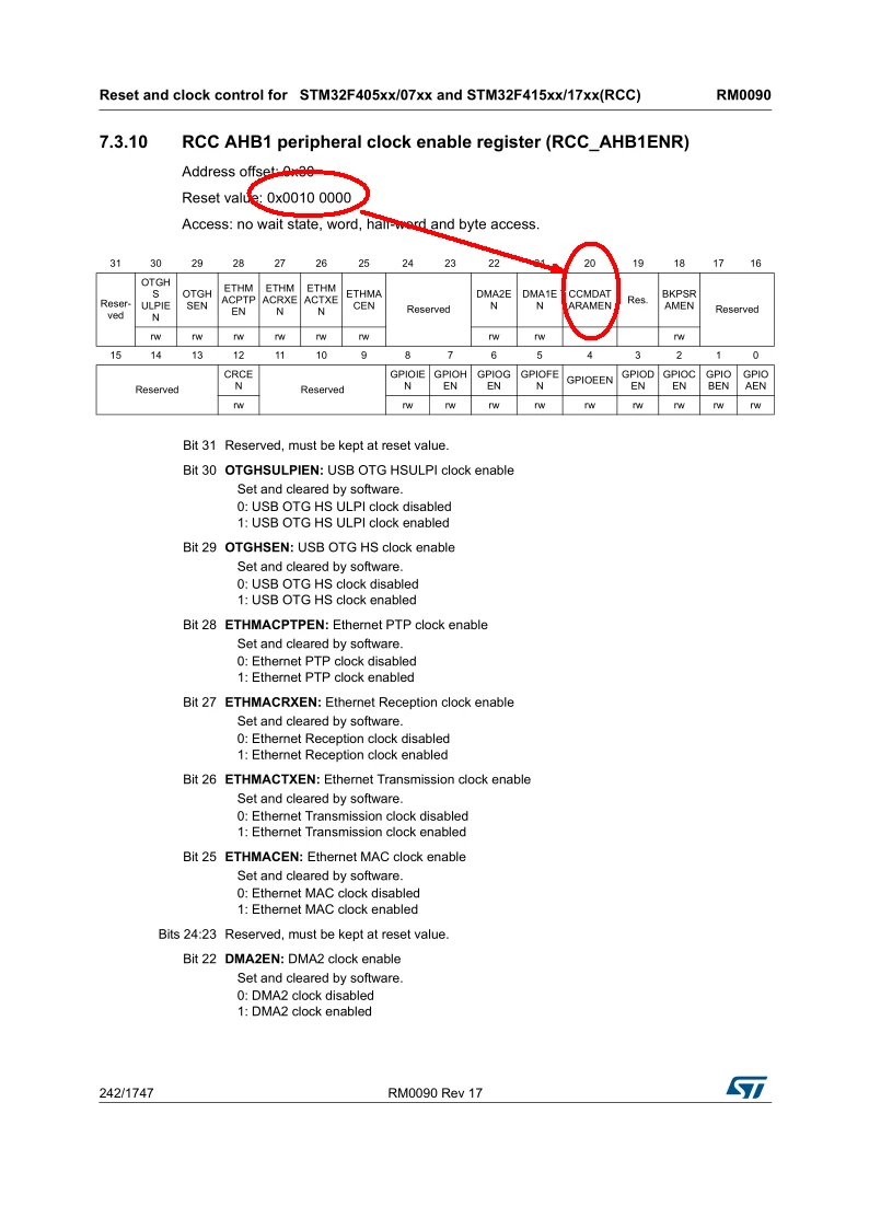

I want to use CCMRAM in 407. Is there a possibility of getting malloc to allocate CCMRAM instead of regular RAM? I changed the linker script to put stack and heap in CCMRAM but the issue is CCMRAM clock has to be enabled before any call takes place.

To overcome this problem I modified the start up assembly file by enabling the clock (AHB1ENR bit 20) at the very beginning. The program which was freezing before enabling the clock started working but stops/freezes after executing a few C statements. I can declare global variables in CCMRAM by providing attribute, but this is resulting in a large chunk (if I use a buffer of say 32K in CCMRAM) FLASH or program memory of 32k is getting filled with 00s (I think to copy initialized variables at start up). What is the workaround please? Thank you for your time.

Do you mean STM32F407? In that, CCMRAM *is* enabled after reset:
0693W00000LyBtQQAV.pngso if you have problems with it, the source of those problems is something else (that's why adding initialization did not solve the problem).
"Stops/freezes" is not a helpful information. Debug as usually, start by observing in debugger, where is the program counter.
Placing variables/heap/stack to CCMRAM is toolchain-specific, so you should tell us what toolchain do you use and in that, what exactly did you do, what is content of linker script etc. If you use the GNU linker (used usually with gcc), in linker script you can prevent storing initialization data using the (NOLOAD) directive for output sections, but then you have to treat variables allocated there accordingly.

Hi waclawek.jan,
Thanks for the reply. I am using GCC (CubeIDE). My program prints a lot of messages after testing some portions of HW before going into an infinite loop to execute series of functions. As suggested by you, I will debug the code and see where the problem is. However I would like to mention here that the program works without any problem as long as the stack is set to RAM (original linker file). CCMRAM clock is not enabled at reset. It needs to be enabled in the code. Since I set the stack pointer to CCMRAM, I modified the assembly start up file to add the following before a call is executed. The code started working after I enabled the clock. Also in the diagram you have posted, there seem to be some confusion. as per the binary value shown there the bit to enable CCMRAM clock is BIT 5 but it is actually bit 20 in the register. Here is the code I wrote
 ldr  r0, =0x40023830
 ldr  r2, [r0]
 orr  r2, (1 << 20)   //0x100000 // set bit 20.
 str  r2, [r0]    //                1  0  0  0  0  0

In linker script file my script is as follows
/* Highest address of the user mode stack */
_estack = 0x10010000;  /* end of CCMRAM */
/* Generate a link error if heap and stack don't fit into RAM */
_Min_Heap_Size = 0x200;   /* required amount of heap */
_Min_Stack_Size = 0x400; /* required amount of stack */
ldr  sp, =_estack   /* set stack pointer. This is the first statement in the start up file. SP is getting initialised to end of CCMRAM
Any suggestions please? After debugging I will share my observations. Thanks once again.
