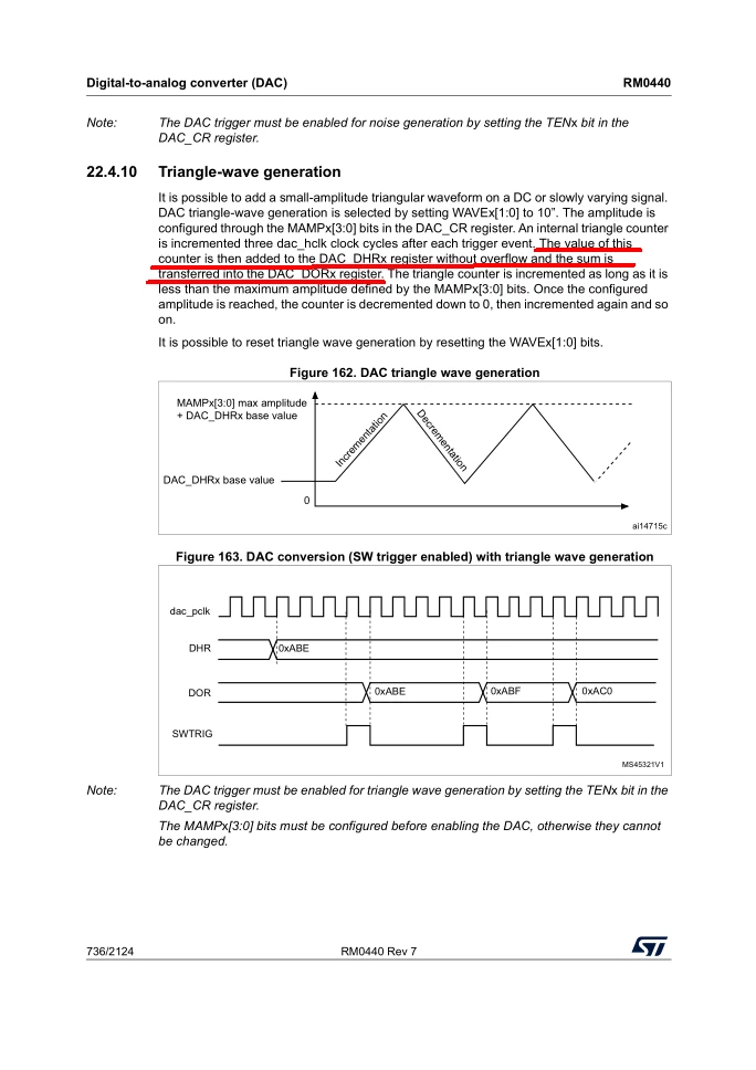

I use DAC sawtooh mode(STM32g431c8T6), Decrement mode.Does the value of DAC_DOR equal to the value of DAC_DHR ?

    No.
