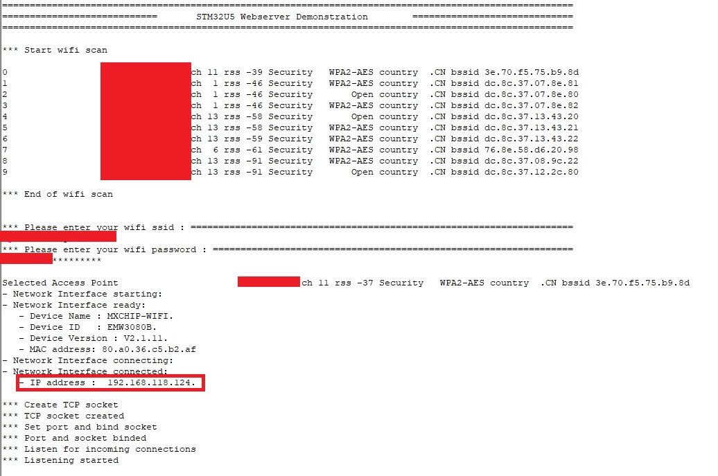

I purchased the STM32U5’s B-U585I-IOT02A evaluation board and trying to bring up default demo of webserver. I get the IP address but when I am trying to connect and open webpage it is not opening. Can anyone help?

I ran the example under this path:
STM32Cube_FW_U5_V1.1.1\Projects\B-U585I-IOT02A\Demonstrations\IOT_HTTP_WebServer\STM32CubeIDE
I did the following:
  • Open the project with CubeIDE
  • download the code to the target which is STM32U5 IOT board
  • Open a terminal with this set-up:
    • Baud rate : 115200
    • Stop bit : 1
    • Parity : none
  • Connect to the WiFi network listed in the terminal(as shown in the screenshot)
  • An IP address will be created for your device as shown in the screenshot
  • put the IP address in the web browser URL,then the web page will appear
0693W00000SuXIMQA3.pngAs a terminal I used Hercules

I tried this and after trying all available guidance on web I had no luck. I do get IP address from board but browser doesn’t open anything

Thanks for your reply. For sure my other device is also connected to same AP. In fact I can ping to the module. It’s just that webpage not opening. I’m surprised that no one else has faced this issue.
