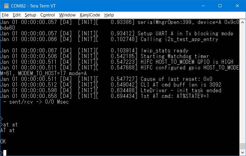

it should be OK to connect USB-UART CN10;
select one of virtual COM port, with recognized message.
​configure with 115200,8,n1. no flow.
key in the Return Key, user should see the prompt character '>'. then you may input at command: "at at" and input Return, user should see expected response

2 COM ports will be visible when USB-UART CN10 of B-L462E-CELL1 board is connected to PC, by default the CLI port should be enabled.

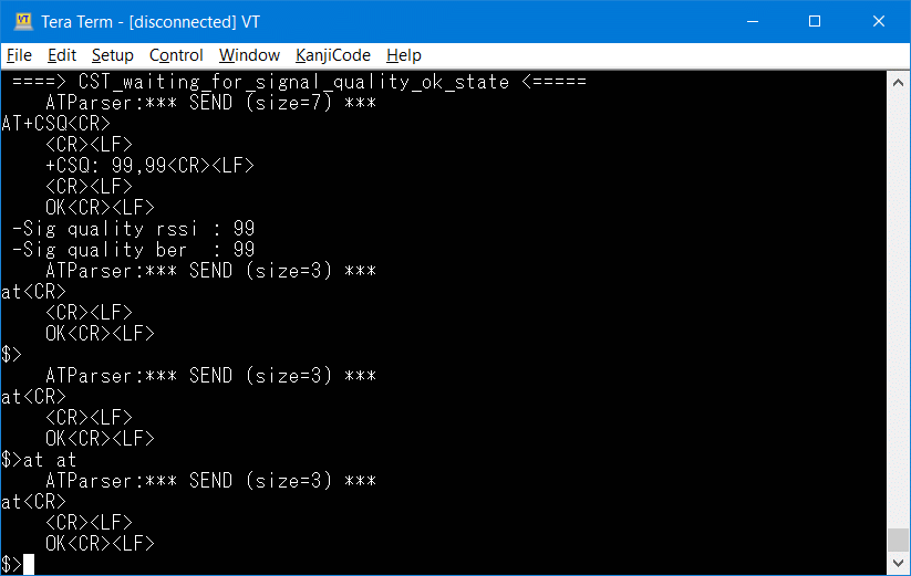

STlink USB connector (CN9) , at command response, for B-L462E-CELL1 board :
