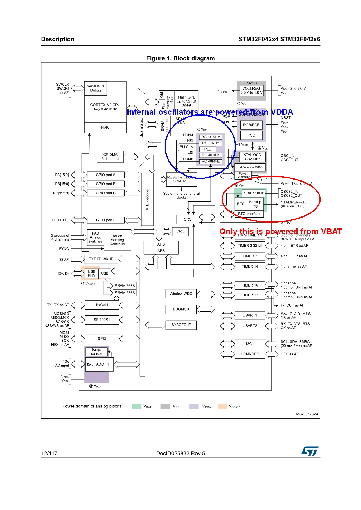

Hi, I did never ask in this forum but used STM32 MCUs for years. Allways I use 48+ pin parts and all work like a charm. I'm very happy with the family and did stop to use other Cortex brands years ago.
In 2019 I did work in a project that did involves 2k units and use STM32F042K6T6. All working ok, but to overcome the future chips shortage I bought in excess of units to use in the next project that implies the use of RTC calendar and backup registers. COVID and other issues delayed the project until last month that have had the time to start it. When I was finishing the design, last week I notice that parts with less than 36 pins din't have VBat.
Datasheet announces RTC backuped with VBat as a feature of the entire family and NOTHING say's about "in packages less than 48 pins this function it's not available". When I check with other stm32F devices in 32 or 20 pin packages the same occurs, NO Vbat.
Exist any alternative to overcome this issue? I'm not really comfortable buying a lot of more expensive parts only to have the battery backuped RTC that is announced for all the packages in the datasheet. By the way, what it's the sense of have a full featured RTC even with backup registers if I never can use it when VDD is disconnected? I need to reprogram the device every time that power is off?

See AN4718. Except for two Schottky diodes, it's purely a software issue. You won't get down to the very same current draw as with VBAT pin, but still acceptable.

waclawek.jan
November 25, 2022
> If the datasheet would said "Available only in Vbat pin packages"
Wouldn't it be strange the datasheet to say "VBAT pin is available only in VBAT pin packages"? :) I agree that documentation can always be improved, but in this case, as you remarked yourself, RTC is still in fact usable albeit in a limited fashion. And, as Clive pointed out above, in the 32-pin (and less) packages, you don't have OSC32 pins either, so you can't use RTC in its full capacity anyway.
Coincidentally, we've had a thread here recently, where a similarly frustrated user complained that only a limited subset of bootloader options is available on the lower-pin-count deiveces, and also those are in conflict with similarly limited options for peripherals connections. While some such limitations are obvious - e.g. if all pins for a peripheral are available only in higher-pin-count packages - some are rather convoluted - e.g. if *most* pins for a peripheral are available on the lower-pin-count package but those are not sufficient for *every* possible configuration of a peripheral. What to do in that case?
What could be done instead of writing a bunch of "this and that does not work in this and that peripheral" - which will lead to DS bloat and half-truths such as "there's no FSMC in 'F4 below 144 pins" (which is not true, FSMC is still there just not usable for its most common purpose - ST corrected that one later but there was discussion around it) - it might perhaps be better to write an appnote discussing issues arising from omitting pins in depth, perhaps with a bunch of examples like this one; and the add link to that appnote to every smaller-than-maximum-pin-count STM32's web folder. @Imen DAHMEN​  , can such "broad request" be brought up in some way?
> How is connected internally the Vbat pin when it's no externally connected?
It is probably left unconnected, but in fact it does not matter, both ways the result is the same: if there's no VDD, there's no VBAT; and if there's valid VDD, VBAT is internally switched to VDD exactly as it is when VBAT pin is present.
So, in both cases, you need to keep VDD powered, if you want RTC to run.

" And, as Clive pointed out above, in the 32-pin (and less) packages, you don't have OSC32 pins either, so you can't use RTC in its full capacity anyway."
I answer that, LSI it's in VDDA domain that can be energized without Vdd. "The VDDA voltage level must be always greater or equal to the VDD voltage"

waclawek.jan
November 25, 2022
One more thing, which you maybe overlooked:
> Osc32 it's not a problem to me, I can calibrate internal oscillator with good aproximation for this aplication
No, you can't use any of the internal oscillators in VBAT mode. Only LSE works in VBAT mode.

November 25, 2022
Jan, I did use thousands of units of STM32 MCU with more than 64 pin with RTC and Vbat, and use 2 thousand of the 32 pin in an application that not use RTC, I carefully read datasheets and design in function of that. Allways the missing features are warning in the family table description.
