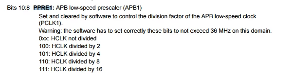

How to use APB1 prescaler in stm32F100
  • April 6, 2017
  • 1 reply
  • 1166 views
Posted on April 06, 2017 at 15:27
Which register to be used?

    Anand Krishnan
    April 6, 2017
    Posted on April 06, 2017 at 16:02
    okay. I do have the related reference manual but cant understand which particular register to use. Nothing is mentioned.
    Technical Moderator
    April 6, 2017
    Posted on April 06, 2017 at 17:15
    You should refer to the ''Reset and clock control (RCC)'' inside the RM0041, exactly the Figure 8. STM32F100xx clock tree (low and medium-density devices) to have idea about clock tree and in the ''Clock configuration register (RCC_CFGR)''
    You can use STM32CubeMx which is a graphical interface performs easy configuration and clock tree. (Please refer to ''Clock tree configuration view'' section on the UM1718 user manual).
    Hope this help you.
