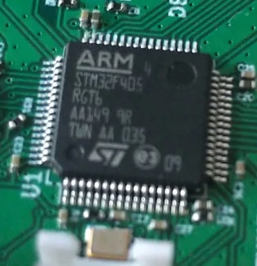

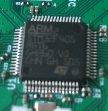

Update: I got some pictures of each MCU type. The newer boards seem to have a revision 2 IC, the older ones a revision 4. The date code seems to indicate the problem MCUs are at least 6 years old?
This is the MCU on the second (later) batch of boards, not working:
By comparison this is the MCU on the first batch of boards:

Let's just assume for start, the mcus in second batch are also OK, but there's some other problem.
Try to be specific in "doesn't work".
Can you program the chips using SWD? If you run some simple trivial blinky, does it run?

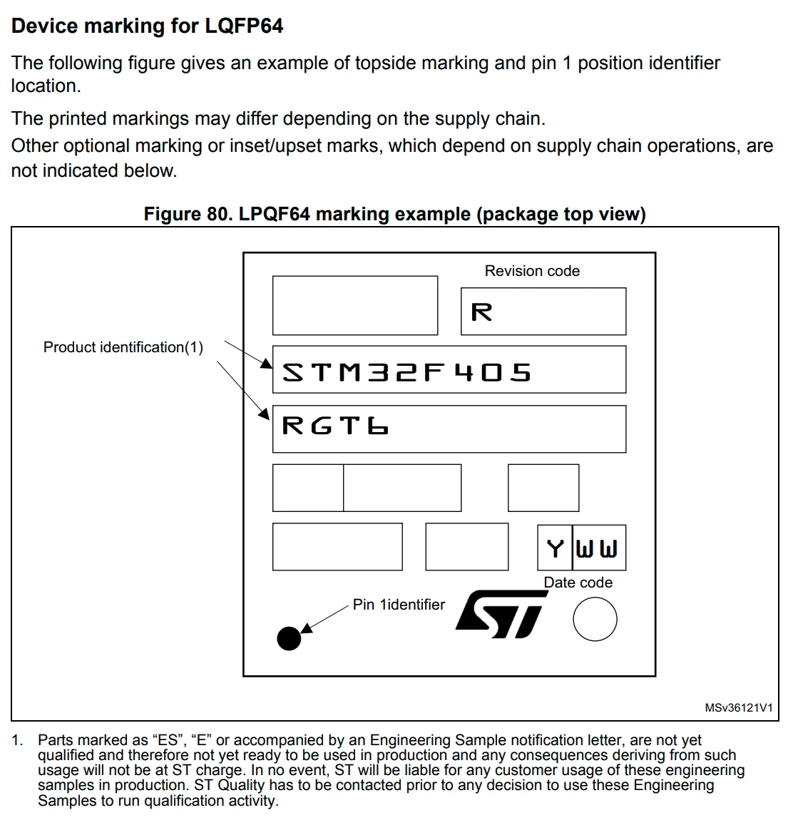

June 22, 2021
The datasheet will have details on marking.
The top picture looks more like the marking I've come to expect.
