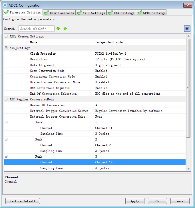

    If you want to read multi-channel-adc, DMA Mode maybe the better way to do it, for example
    PC1 ------> ADC1_IN11,
    PC4 ------> ADC1_IN14,
    PA2 ------> ADC1_IN2,
    PC5 ------> ADC1_IN15
    1. ADC Initial : for channel with 4 different rank
    /* ADC1 init function */
    static void MX_ADC1_Init(void)
    ADC_ChannelConfTypeDef sConfig;
    /**Configure the global features of the ADC (Clock, Resolution, Data Alignment and number of conversion)
    hadc1.Instance = ADC1;
    hadc1.Init.ClockPrescaler = ADC_CLOCK_SYNC_PCLK_DIV4;
    hadc1.Init.Resolution = ADC_RESOLUTION_12B;
    hadc1.Init.ScanConvMode = ENABLE;
    hadc1.Init.ContinuousConvMode = ENABLE;
    hadc1.Init.DiscontinuousConvMode = DISABLE;
    hadc1.Init.ExternalTrigConvEdge = ADC_EXTERNALTRIGCONVEDGE_NONE;
    hadc1.Init.ExternalTrigConv = ADC_SOFTWARE_START;
    hadc1.Init.DataAlign = ADC_DATAALIGN_RIGHT;
    hadc1.Init.NbrOfConversion = 4;
    hadc1.Init.DMAContinuousRequests = ENABLE;
    hadc1.Init.EOCSelection = ADC_EOC_SEQ_CONV;
    if (HAL_ADC_Init(&hadc1) != HAL_OK)
    Error_Handler();

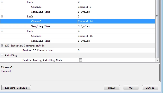

    /**Configure for the selected ADC regular channel its corresponding rank in the sequencer and its sample time.
    sConfig.Channel = ADC_CHANNEL_11;
    sConfig.Rank = 1;
    sConfig.SamplingTime = ADC_SAMPLETIME_3CYCLES;
    if (HAL_ADC_ConfigChannel(&hadc1, &sConfig) != HAL_OK)
    Error_Handler();
    sConfig.Channel = ADC_CHANNEL_2;
    sConfig.Rank = 2;
    Error_Handler();
    sConfig.Channel = ADC_CHANNEL_14;
    sConfig.Rank = 3;
    Error_Handler();
    sConfig.Channel = ADC_CHANNEL_15;
    sConfig.Rank = 4;
    Error_Handler();

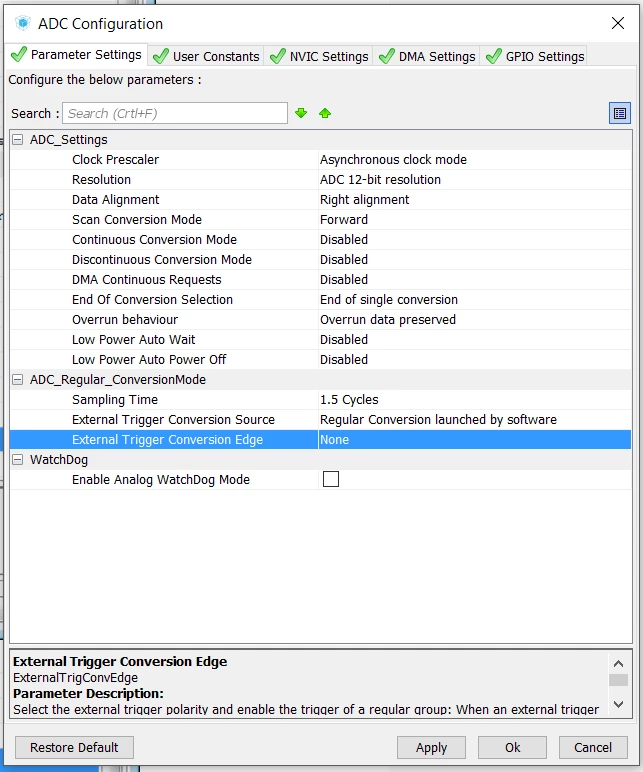

    I think the MCU I'm using is more limited than yours. This is what I can configure in CubeMX:

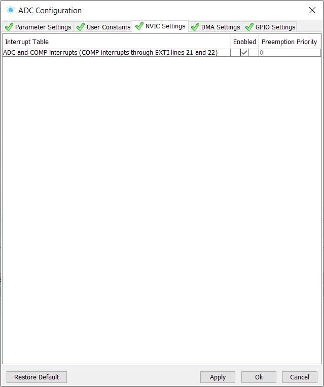

    I haven't find any way to configure different ranks for each ADC channel. What I have finally done is to enable the ADC interrupts and work in interrupt mode:
    It seems to work fine but I would like to know if there is any way to us the DMA as well.

    Marco S
    Marco SAuthor
    April 17, 2017
    Posted on April 17, 2017 at 12:50
    The rank number appears as a fixed number in the HAL of the ADC:
    ♯ define ADC_RANK_CHANNEL_NUMBER , , , , , , , , , , , , , , , , (0x00001000U) , /*!<, Enable the rank of the selected channels. Number of ranks in the sequence is defined by number of channels enabled, rank of each channel is defined by channel number (channel 0 fixed on rank 0, channel 1 fixed on rank1, ...) */
    It is not clear to me how does it work or how could I change it.
