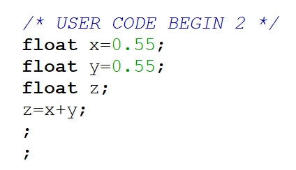

Thank you for your patronage. I'm using STM32F3348-Discoverywhich has FPU and EWARM.
I made calculations like the picture below.
I'd like to check if floating point arithmetic is calculated correctly. So,I added z to EWARM live watch. Butz indicated an error.In case of integer operation, it is correctly displayed.How can I do it?
Best Regards,
Ken Inoue

    Posted on November 09, 2017 at 10:39
    Having paid the considerable licence fee for EWARM, don't you think you should be asking them about difficulties with their product ... ?!
    https://www.iar.com/support/technical-support/
    But, anyhow, what is the text following 'Error(...' in your screenshot?
    General points - not specific to IAR:
    • Is z in-scope at the point you are trying to observe it?
    • Is the value of z ever used for anything non-trivial?
      If not, the compiler may well have optimised it away...

    174712CGIL2
    Andrew Neil
    November 9, 2017
    Posted on November 09, 2017 at 12:10
    Do you understand the concept of scope in the 'C' programming language?
    A variable is not visible outside its scope - not even to a debugger ...
