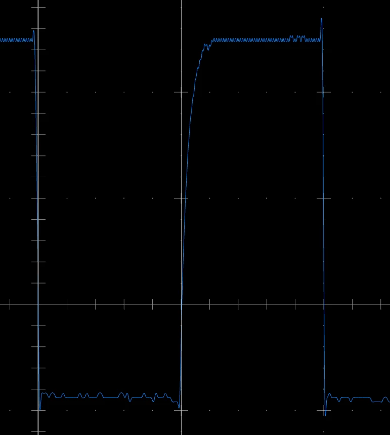

My idea was simple. Set TIM to have 1MHz after prescaler. Then set ARR to the number of microseconds. So - I toggle GPIO pin each period elapsed and I can measure the time on oscilloscope.
And here come troubles: for set 1us i get 2us. For 2us I get 2us. For 5us I get 5us.
So - times below 2us are unachievable. But it's fine, the shortest time I need is 6us.
But then again, I don't need to spam the interrupts every 6us, I need it only when I send a data bit. So - I set the TIM in the "One Pulse Mode". And here comes another surprise. Whatever time I set - circa 1.9us is added to it.

Here's my signal (5us/div):
0693W00000Stu7FQAR.png99.6KHz, accurate enough for what I need.
But why do I need to add 19 to the CNT? This is the time lost somewhere, is it between the timer reaching zero and interrupt triggered? Does it take 1.95us?
The MCU is running on 400MHz clock. The few lines of code in the interrupt handler don't affect the timing at all. When I don't restart the timer, when it runs continuously, I can set any time greater than 2us and it's totally accurate.

HTD
HTDAuthor
Senior II
August 27, 2022
That's what I think, better not touch the prescaler during transmission, even if it would work it would probably introduce glitches / jitter.

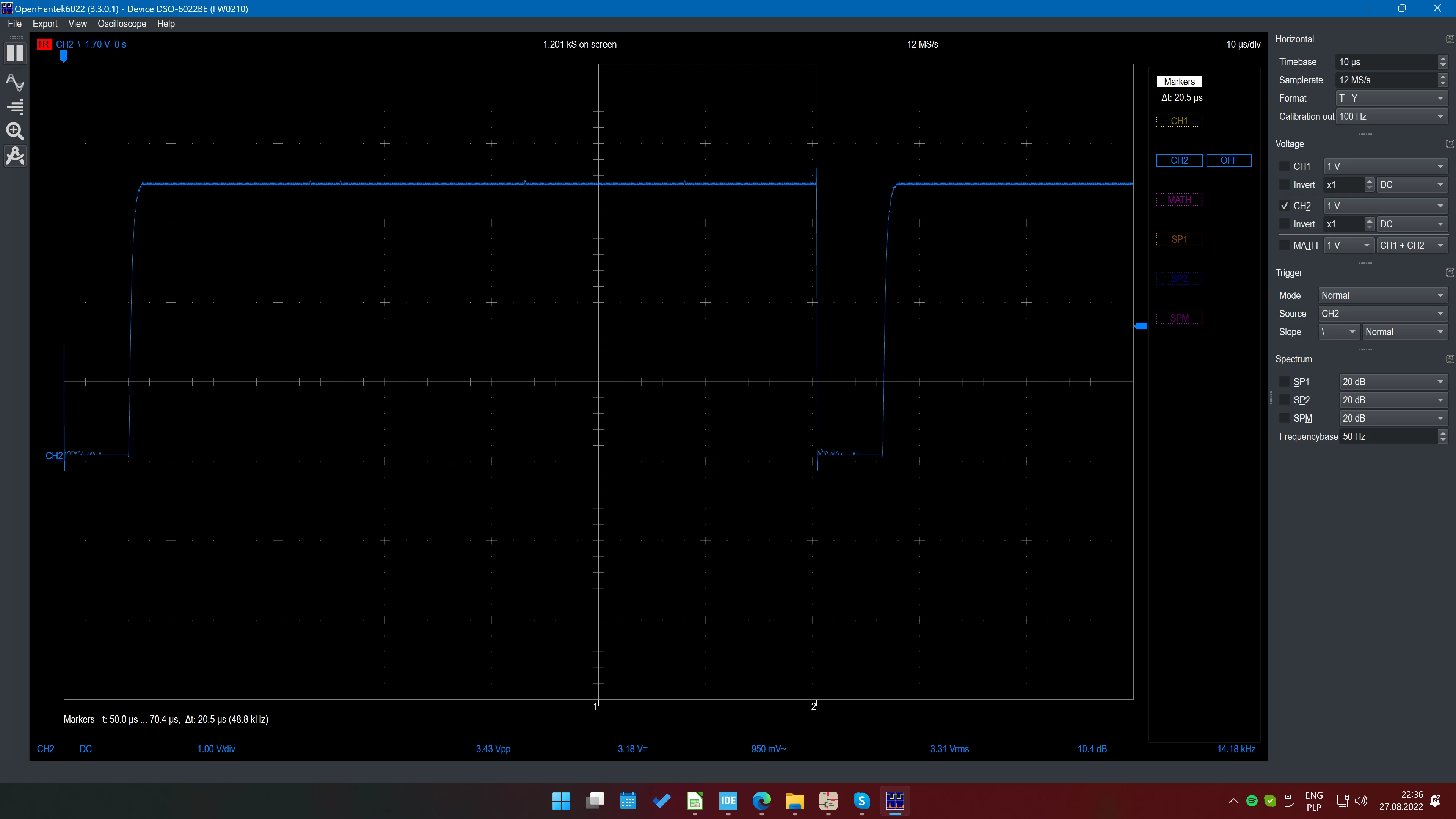

Here's my example of sending a sequence of 6us L and 64us H (as in 1-Wire bit 1):

It takes exactly 1.93us to compensate for the interrupt delay. However, the signal on the scope looks exactly as it should look. It's generated in a loop and I tried to swipe the touch screen to introduce some interrupts - no visible change in behavior except very small, negligible jitter.
