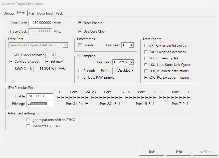

I am using the MDK-ARM tool to develop our application.

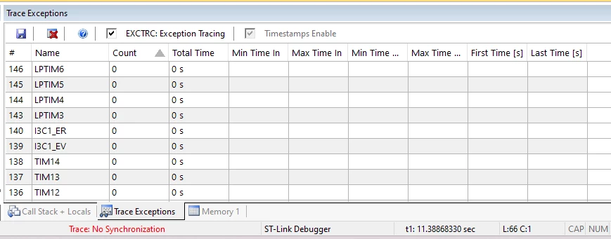

When I enable the "Trace Exceptions" function to trace all exceptions, it always show "No synchronization" in red below. And no exception can be seen from the table.
I also uploaded the trace clock settings as below. I guess that I may config wrong track clock.
Is there any suggestions you can provide to me? Thanks.

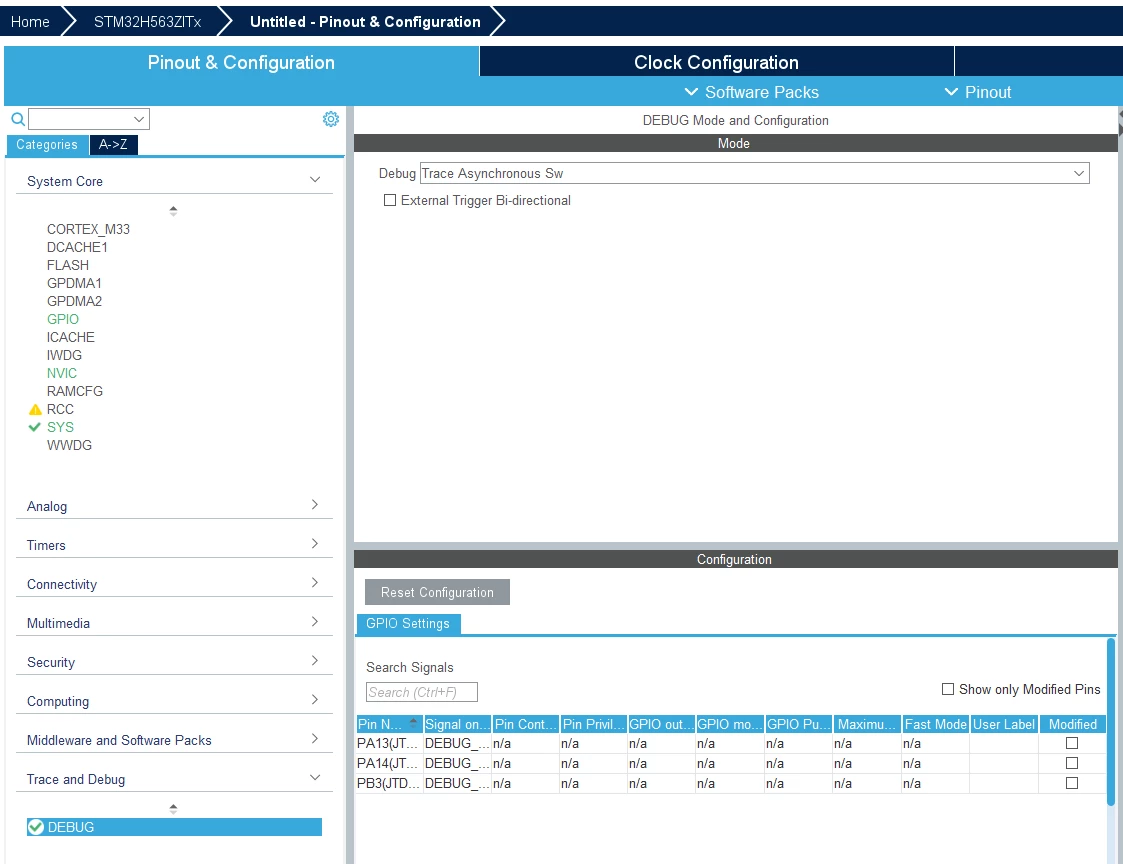

Hello @english0815 ,
In STM32CubeMX:
Select "Trace Asynchronous Sw" in Debug selection box as shown :
Hope it helps!
