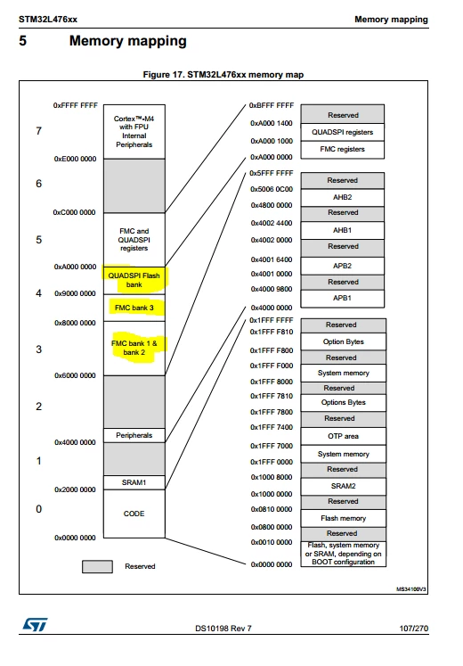

Determine if you are going to use an 8-bit or 16-bit data bus, and then look at how many address bit you're using

as per this memory mapping diagram below is to consider maximum SRAM calculation.
For FMC Bank 3
0x1000 0000 address available
AddressLine is 16 bit
Dataline is 16bit
Now how I can calculate total supportable SRAM?

Depending on the bank you're looking at 64MB or 256MB, probably more than you can afford to implement externally.
It's is likely to also be constrained by the pins available on the specific device you're using, and you don't specify that.
You also don't really specify what you're attempting to achieve in your design, and that's going to drive appropriate chip choices.

I am going to use STM32L476VGT6 Controller, Now I need to calculate how much external SRAM memory can be interfaced with
STM32L476VGT6
I am going to use 16 data lines.
0x10000000 address available and data bits is 16.
For memory calculation
= 0x10000000  x 16  (0x10000000 converted to decimal)
= 268435456 x 16
= 4294967296 bits
= 4194304 Kbits
= 512 MBytes
So we can add up to 512MB SRAM external to
STM32L476VGT6.
Please Correct me if something wrong calculation is done.
