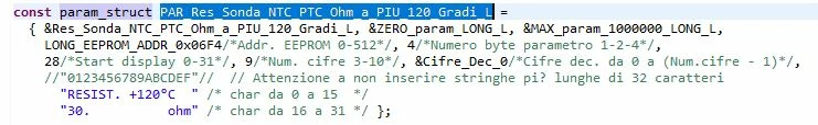

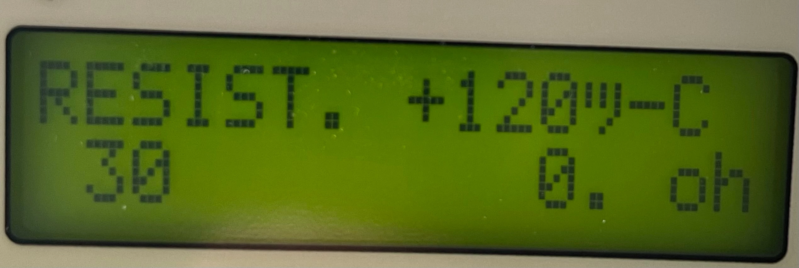

Hi, I would like to print to the screen a string, reported below in Details, with the celsius degree symbol "°". However, I find other characters if I look to the screen. Is it possible to change alphabet with some option of the STM32CubeID to find "

    This has nothing to do directly with the STM32CubeIDE, but with the character set that your display supports. You would have to look at its datasheet and find out if it has the DEGC character in its character set. If it does, you would have to send its hex code as a character, but that would only apply to that particular display.

    with the following code variation I've the symbol "°" in the display. I don't know why I can't write == '°' and leave "°C" instead of =='?' and " ?C". If I do so the if condition is skipped. 0693W00000Y92NGQAZ.jpg0693W00000Y92N6QAJ.jpg0693W00000Y92N1QAJ.jpg

    Well, you have not yet inserted the character set of your two-line LCD here. As a rule, the character set only partially matches that in operating systems such as Windows, Linux or MacOS, mostly only in the ASCII range 0x20 (space)...0x7D (left curly bracket).
    However, on many of these LCDs, the question mark is usually coded with 0x3F and the degree sign with 0xDF.
    You should now check:
    • how the character set of the LCD is defined,
    • which byte your compiler generates at the position of the question mark and,
    • if necessary, replace the question mark, which is not recognisable as a degree sign in the source code, with the corresponding hexadecimal code.
    I would also check how the display routine converts the bytes to be sent to the LCD from the input string.
