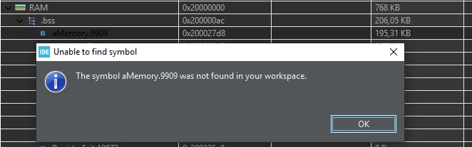

Hi, i'm just checking my RAM since i have an slight overflow of 6KB. I want to optimize it but unfortunately i can not access the aMemory in .bss. Does anybody has an idea why and how to solve this? Best Regards

This just lacks any context.
Is this coming from a library?
Perhaps grep within your workspace or the libraries/files it touches.
Perhaps look for "aMemory" rather than the fully qualified name.
Perhaps look at the .MAP file

Came from a library which occupied some RAM. Segger emWin lib with "#define GUI_NUMBYTES" i was able to adjust it.
