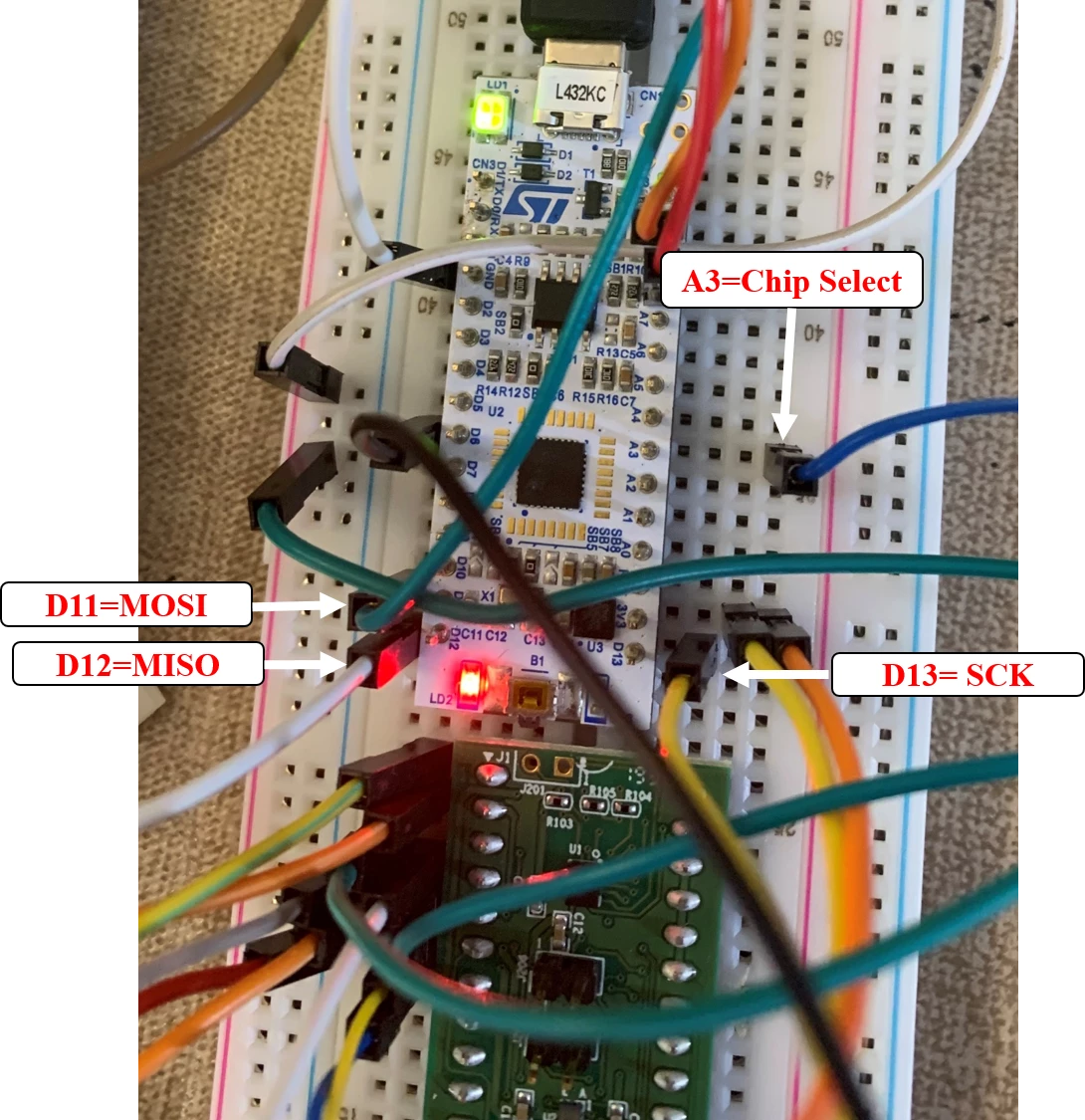

Hi I am going to get sensor data from the BMI160 through SPI with ST32L432KC. I appreciate it if anyone can help me with how I can configure the SPI. Thanks

Thanks for your reply. Please kindly find the pin connections for SPI connections.
Also, the piece of the code that I am using to get gyro data is as follows. In this code, I followed the procedure explained in the Bosch GitHub, here. The problem here is that it doesn't update the gyro variable. Also, tested with the logic analyzer. Seems it is not changing on the pins.
Thanks

Tesla DeLorean
Guru
July 28, 2020
Look very Arduino, not HAL
Is this not working? Is it compiling?

Would have chosen I2C myself.
How have you got it connected? Written any software for this, or expecting others too?
Some SPI interface examples in the BSP code for the example boards, try porting that into your target.

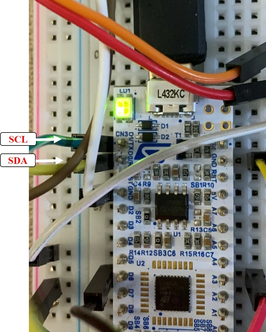

I am trying to connect the shuttle board with I2C in Arduino IDE. It mentions that the code is not compile-able in for Nucleo-32. Please see the piece of code for reference. The library of the Hanyazou is used.

@Community member​ , Here I am going to use the wire.h library written for i2c connection. Also the pins used for SDA and SCK are as follows:
Is it true to use these two pins for i2c?
Thanks
If pins are not sending the signals, ensure they're configured correctly. Look at the GPIO registers. Looks like Arduino code, which I'm not really familiar with.

Got bmx055 and bmw160 working in i2c modr witg bit banging to keep bringup time brief. Bosch provide an spi and ani2c function for developper to.fill up. Then there is a.demo function code to power up, run one shot measurement and power.down the sensor. That is the one to use. Do check prrsence of the sensor by reading a chip id...
