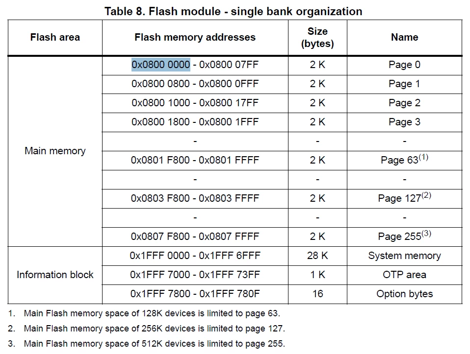

HAL functions are notoriously difficult to work with. Unless you use them exactly as they are used in the example projects, there is no guarantee that they would do what you think they should do, and if they don't, the documentation is not really helpful in troubleshooting. You'd get results more reliably by using the register inerface directly, which is documented in great detail in the reference manual.
1. Check whether the flash is locked. Examine the FLASH_CR_LOCK bit in the FLASH->CR register.
2. If the flash is locked, unlock it by writing the appropriate values in the FLASH->KEYR register, as described in chapter 3.3.5 of the reference manual.
3. Check the FLASH->CR register again to see whether the unlock operation was succesful.
4. Check the FLASH->SR register before and after each following step for possible errors. Clear the status register by writing back its value & 0xFFFF after you have identified and remedied the cause.
5. Check the memory map of your program to find a flash page which is not already occupied by code or data.
6. Find the address range corresponding to the page number using the table above.
7. Erase the flash page as described in 3.3.6 Flash main memory erase sequences. Check the status register.
8. Write data to the flash as descibed in 3.3.7 Flash main memory programming sequences. You may have to flush data by issuing a __DMB(); instruction after each write. Check the status.
9. Lock the flash.
If you are stuck, show the code (using the </> symbol below), explain what it should do, what do you get instead, and post the values of the flash controller registers in order to get a meaningful answer.

You're erasing page 1, which isn't at 0x08000000. Page 0 is.

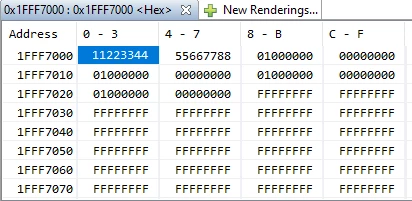

The thing is that i can write only to OTP address which i can not change after that
Gbasi.1
Gbasi.1Author
May 17, 2020
berendi
Principal
May 17, 2020
Fine, it works properly then.
