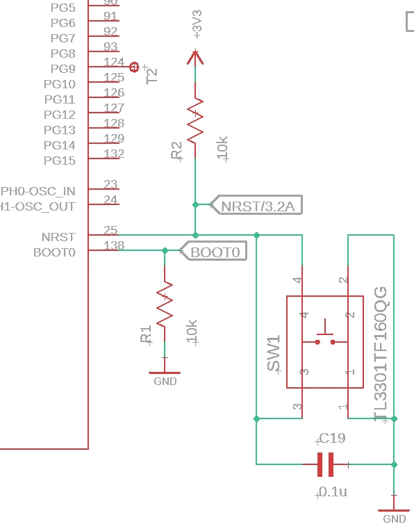

Good morning,
my product is made of 2 parts, each of which has a dedicated MCU. MCU1 is STM32L476ZG and MCU2 is STM32L4P5CG. The whole device is supplied through a wall adapter working at 24VDC. Internally,the voltage is converted to supply all the module with the required voltage. The 2 parts communicate via UART, set with a baud rate = 9600, very low. The communication is not continuous but is event-based.
The software implementation was straight forward and all works BUT it stops working when the following happens:
1. I upload the software in the MCUs via the ST debugger
2. I unplug the debugger (all good so far: the software works fine)
3. I unplug the supply (mains adapter) from the device and plug again.
At this point the communication fails and UART sends only zero. This is even weirder: if I press the reset button on the board (schematic attached), the communication starts working again. Honestly, I cannot understand why the communication fails when the supply is turned off and it recovers after pressing the reset button. Any idea?
Thank you all and I am happy to add more details if needed.

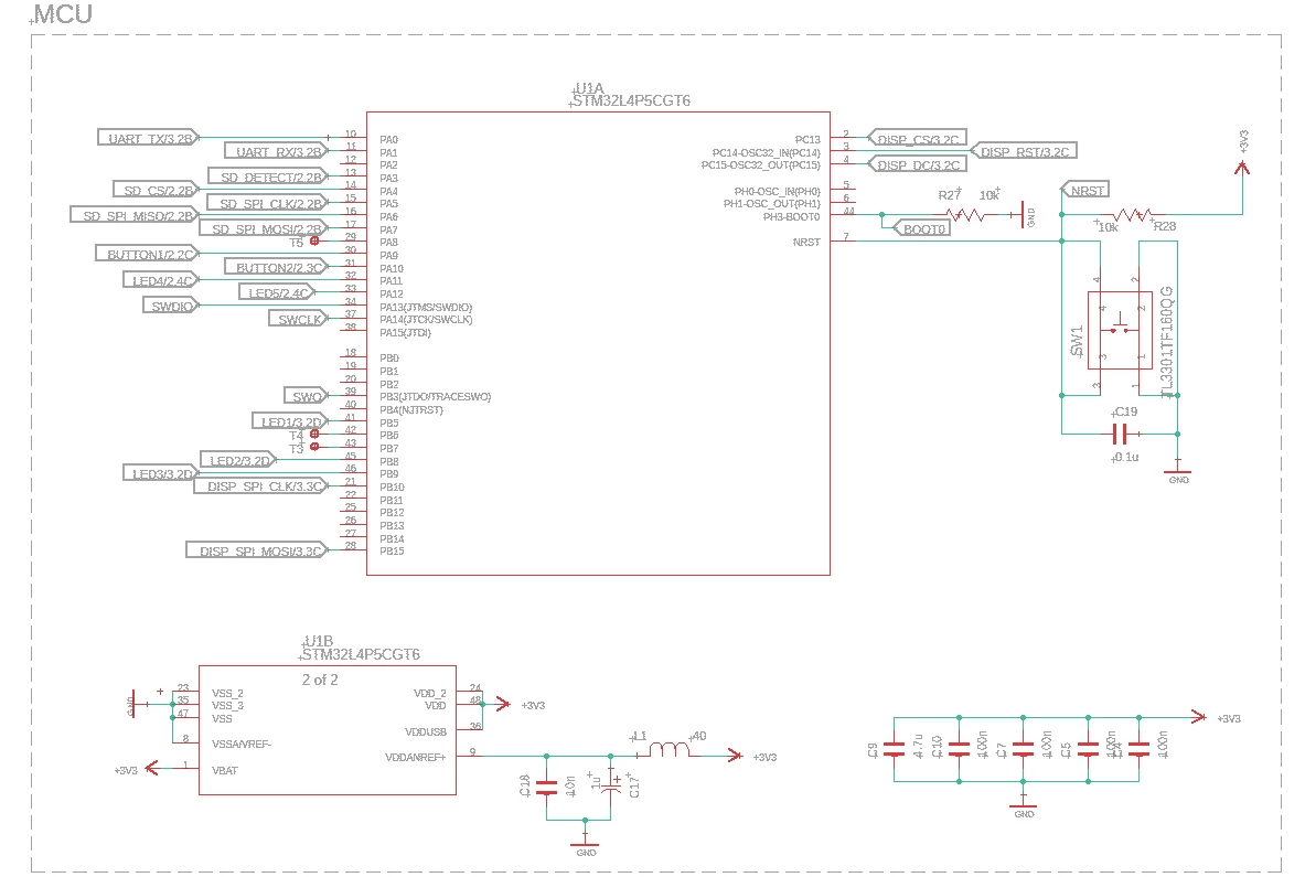

Typically there is no external pull-up on NRST, just the cap to GND.  I wonder if the resulting power-on reset pulse is too narrow for a valid reset?  That may also happen if your 3.3V supply takes too long to ramp up.  You don't show your power supply section.
Check the UART output with a scope and make sure it really is sending at 9600 baud (when you see '0' characters).
Where else does your "BOOT0" signal go?  If there is anything connected that may allow that pin to be seen as "high" during power-on, that would force the built-in bootloader to run instead of your code.
You don't have a crystal or oscillator on PH0/PH1, so what is your clock source?

Unfortunately this happens even if I don't pull up the NRST pin, so if I desolder the 10k resistor. Here you go the full overview of the MCU:
The BOOT0 signal actually doesn't go anywhere else. It is only pulled down.
About the clock, I use the internal source.
