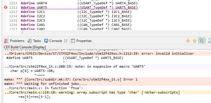

Hello. I was trying to build my project and found a driver error. How to fix it?

UART5 defined elsewhere in your code?
Work in a new generated project.
hth

UART5 is not defined in other parts of the program, only here.

Where is UART5_BASE defined? At a guess you have included an STM32 port definition header that doesn't have the extra UARTs.

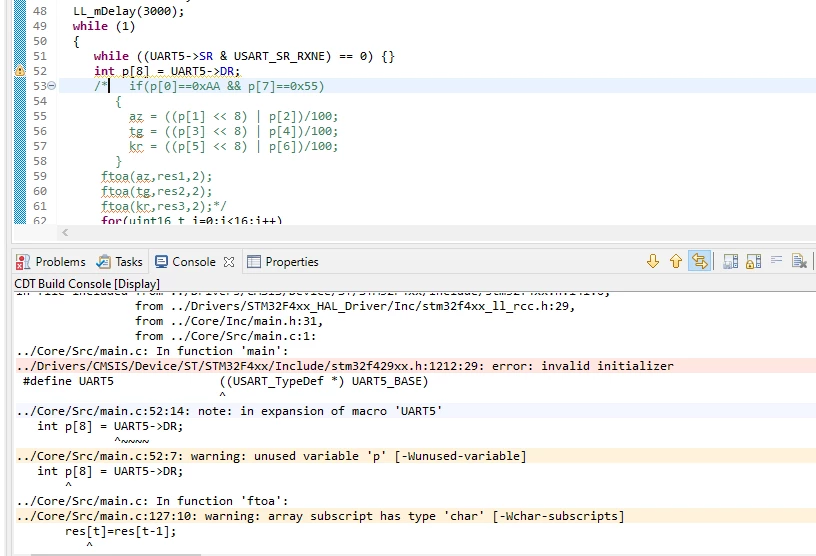

Chip: STM32F429ZIT6U;
Board: STM32F429I Discovery;
CubeIDE version: 1.5.0.

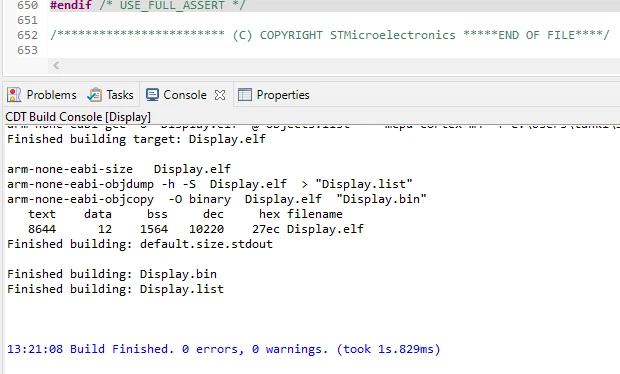

I tried building the generated project without making changes. Everything went well.

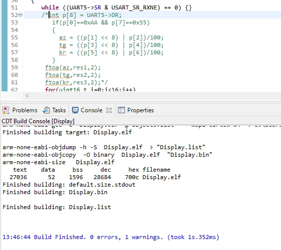

Using the elimination method, I realized that the error appears when trying to read the value from the data register.

int p[8] is an array declaration and therefore, the assignment of a value (UART5->DR) to an array makes no sense and causes errors/warnings. The compiler may not be intelligent enough to give the best error message here.

Thank you very much for your help. I did not understand the dimension of the received data and made mistakes in the code.
