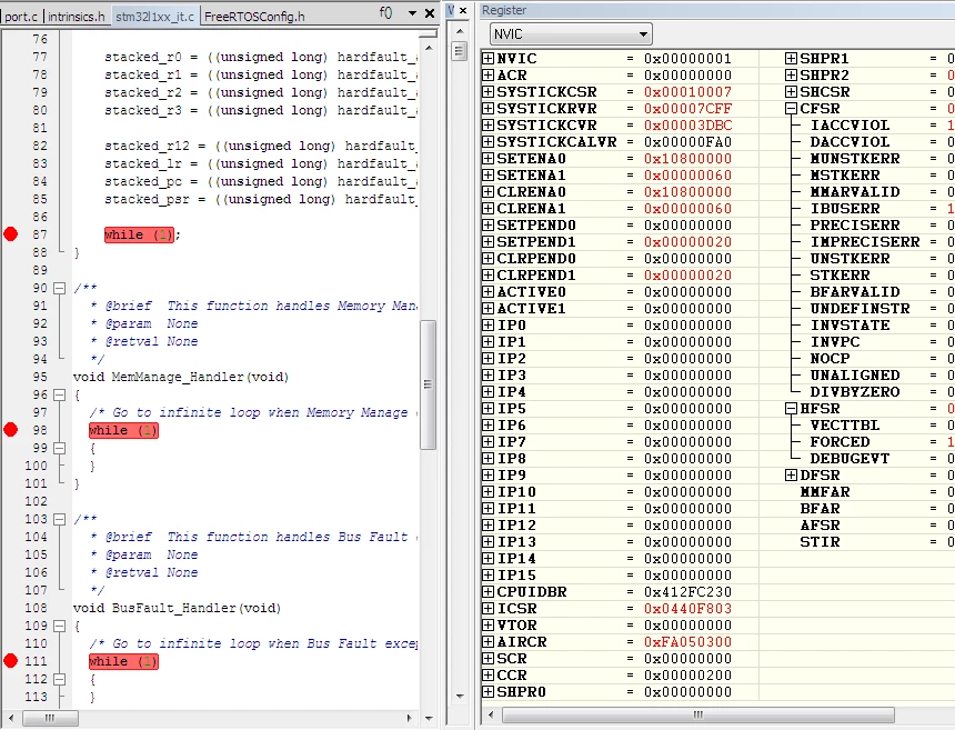

    karthikainala
    March 25, 2014
    Posted on March 25, 2014 at 11:23
    i am using freertos and created 3 tasks, but i get hardfaults inconsistently but i cant capture them always as in the fig above i got memmanang and busfault but i cant get them in the handlers even though i set breakpoints to debug the source of the fault.

    Posted on March 25, 2014 at 11:55
    Let me try a guess: you got IBUSERR because of the MCU jumping somewhere to run code but there is no memory ?
    How could this happen ? Easy: you corrupted stack and some function return (reading LR from stack) simply returns somewhere where there is no memory.
    This guess is based on my experience with FreeRTOS, that definitively set default stack size too small (256 or 512). A simple call to a printf may require up to 2Ko of stack (GNU eabi from codeSourcery). I guess IAR have better (say smaller) implementation of printf, try to use the smallest version of library compatible with your need (example: no float, no wide char).

    Posted on March 25, 2014 at 18:20
    I guess that there is no chance that MemManage and BusFault handler trigger if they haven't been activated properly (show us SHCSR value).
    HFSR says it has forced to HardFault, it's certainly because other handler are simply not activated.
    Then we finally end in HardFault, with IACCVIOL and IBUSERR set, it clearly that code had jumped in the void.
    The breakpoint in HardFault handler is set at the end, it is possible that the very own code of this handler escalate for more errors. Place the breakpoint at the entry of that handler (and pray for IAR debugger to set the breakpoint at the very first instruction and not after any stack accessing instruction or whatever other instruction).
