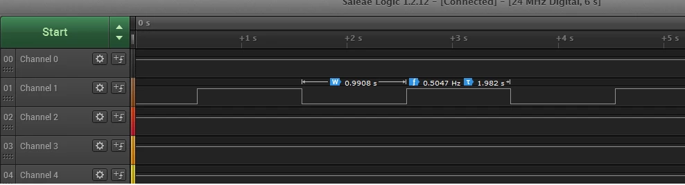

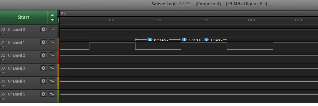

Hello ,
I am toggling a gpio inside the timer ISR . the timer ISR triggers for every 1 sec.
Actually i am not able to see perfect 1 sec of gpio toggling . it also differs at different AHB frequency . i have included 2 cases with snapshot. please help me understand why i can not get perfect 1 sec gpio toggling and why it is different at 2 different ahb frequencies .
In the ISR i am just doing GPIOC->ODR ^= 0x2000U;
case 1 : AHB = 16Mhz HSI, Prescaler of timer = 999, period = 15999  ( in the image there is a difference of 10ms)
case 2 : AHB= 50Mhz, Timer clock = 50Mhz, Prescaler of timer = 999, period = 49999 ( in the image there is a difference of 25ms)
In both case it is showing different output .

    Nigel Meijer
    May 18, 2018
    Posted on May 18, 2018 at 12:51
    A few things have effect on the crystal, Like temperature and supply voltage.
    For example in the STM32L083CZ datasheet on page 87:
    MSI oscillator frequency drift   0 °C ≤ TA ≤ 85 °C -  ±3
    A temperature between 0 and 85 degrees could cause a frequency drift of plus minus 3%
    Same happens with the supply voltage.
    Dont know why with different settings you get a different timing..

    Hard to replicate from screen shots. Define which STM32, and show code.
    Using HSE clock source?
    Can you try with a calibrated scope?
    Can you output internal clocks (HSI, HSE, PLL, etc) via MCO pin PA8, and scope those?

    Hello Clive , ,
    Thanks for the reply . ,
    i am using stm32f446re nucleo board . , not using HSE. ,
    i am using saleae logic usb logic analyzer . i dont have a calibrated scope.
    HSI is 16Mhz verified using MCO. on MCO pin i can measure precisely ,

    From the manual;
    6.2.2 HSI clock
    Calibration
    RC oscillator frequencies can vary from one chip to another due to manufacturing process variations, this is why each device is factory calibrated by ST for 1% accuracy at TA= 25 °C.
    Yor are getting results close to the factory specification.
    Have you calibrated the HSI better than 1%?
    Using HSE from ST-link on nucleo boards has always be much better than HSI in my experience (12-15 boards).
