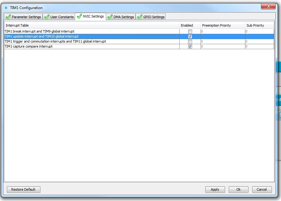

My code is based on the STM Cube generated code.
Ok, so I enabled TIM1_UP_TIM10_IRQn and TIM1_CC_IRQn in the dedicated MSP function.

I start the PWM using HAL_TIM_PWM_Start_IT(&_t_HTIM1, TIM_CHANNEL_3) function.
I go to the CC Handler but not into the Update Handler. Do I miss something?

I don't use Cube. Have you set both interrupt enable bits in TIMx_DIER?

If he generated the project with CubeMX, and enabled the TIM1 global interrupt there is!
he would have a handler like this;
void TIM1_IRQHandler(void)
  /* USER CODE BEGIN TIM2_IRQn 0 */
  /* USER CODE END TIM2_IRQn 0 */
  HAL_TIM_IRQHandler(&htim1);
  /* USER CODE BEGIN TIM2_IRQn 1 */
  /* USER CODE END TIM2_IRQn 1 */
It calls HAL_TIM_IRQHandler(&htim1);
which then calls the event specific handlers;
void HAL_TIM_PWM_PulseFinishedCallback(TIM_HandleTypeDef *htim)
void HAL_TIM_PeriodElapsedCallback(TIM_HandleTypeDef *htim)
