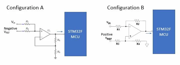

For ADC input, my input signal is sinusoidal with no DC, that is, it has positive and negative value. Is it possible to convert a negative value without problem?
  • November 12, 2021
  • 6 replies
  • 1474 views
In the document, the input level is limited by Vref+ and Vref-. But Vref- seems to be tied to GND in general, which implies a negative value cannot be converted without problem.
Can Vref- be connected external -5V or -3.3 V for handling a negative value?
If not, do I have to add an offset to the input signal before ADC to guarantee the input within 0 to Vref+.
Please let me know.

waclawek.jan
November 12, 2021
https://community.st.com/s/question/0D53W00001BxpkFSAR/as-for-my-recent-post-my-mcu-is-stm32f031k6
No.
Yes.
An appropriate resistive divider, with one end at your input signal, the other at VREF+ (or VDDA) might suffice. You have to take into account resulting impedances and their impact on sampling time; if this will result in inacceptable impedance you would need to perform the shift "actively" e.g. using an opamp.

Do you mean that I have to use an OP-AMP Circuit as shown below?
Please let me know.
waclawek.jan
November 12, 2021
Yes, except in the first schematics the divider should IMO go to positive VREF.

Alternatively, depending on the signal properties, an AC coupling with serial cap followed by mid voltage could be an option.

For better quality, consider using an OPAMP. It will allow you to ​add Vref/2 offset (mandatory), make low pass filter (to avoid aliasing) and drive with low impedance the ADC input. Otherwise, as stated by Jan, it will be difficult to keep a short sampling time vs relative low impedance of mux/sample and hold of STM.
