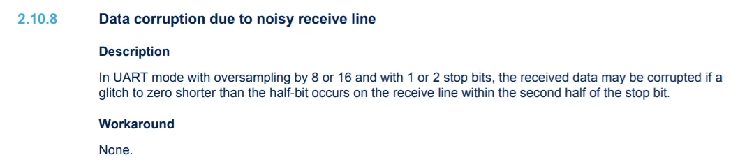

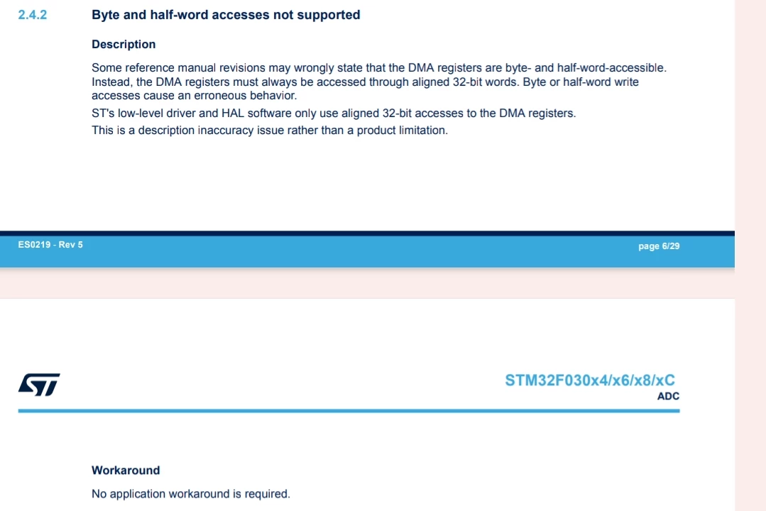

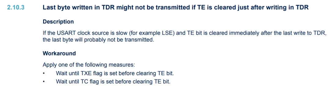

Hello @Hugues Libotte
Maybe one of those 3 errata is the source of your problem.

Maybe  the third one but as far as I read, it seems the HAL_UART_TRANSMIT_DMA and HAL_UART_RECEIVE_DMA deals with uint8 and uint16. But what to set up in the CubeMX config panel.

September 7, 2023
You have to do exactly as sayed in the errata.
