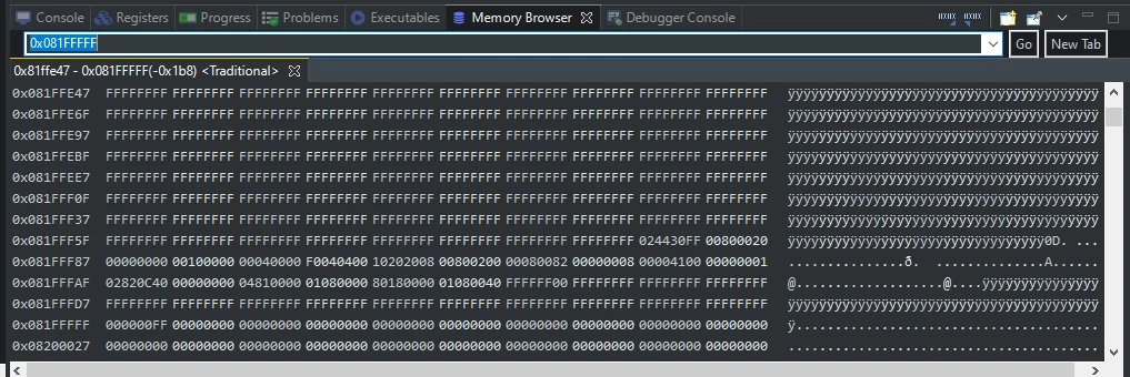

I have STM32F427zi supply with 1V8. And I try to erase his flash from sector 5 to sector 23, but sector 23 is not erased. STM clock is set to 144MHz. Latency set after document RM0090.

For check I use debugger to view data in flash memory. At the picture, you can see that flash memory is wrong erased. The last 0x081FFFFF is end of sector 23.
Any idea, what is wrong?

This is probably ART's Data Cache.

JW: What do you think of the ART's Data Cache?
waclawek.jan
January 13, 2021
The debugger might've presented data from the ART Data Cache. Similarly as you disable/enable the instruction cache above, you should do with data cache, too.
True, the data cache is 4 lines x 128 bits i.e. 64 bytes, and what you've shown was 128 non-FF bytes, so that was not the problem here.

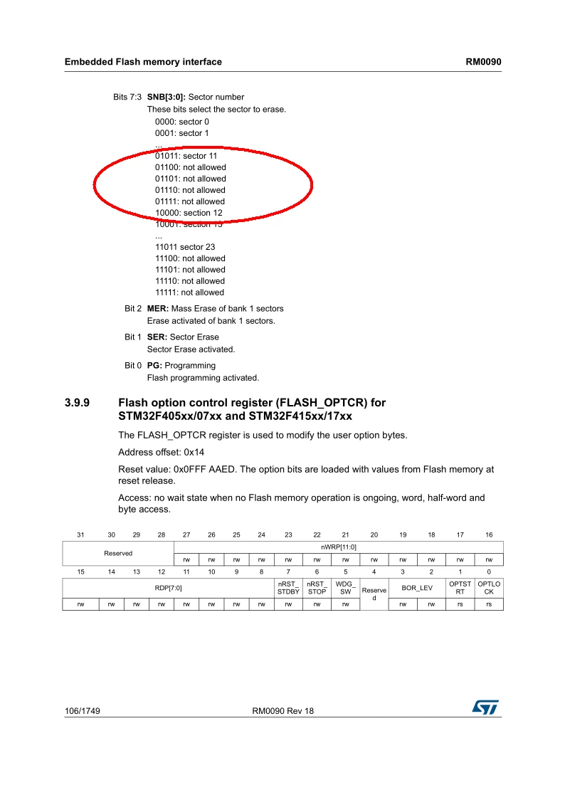

An error was found.
int OCFLASH_SectorErase(int sector)
 if (sector < 0 || sector >= OCFLASH_SECTOR_COUNT)
 return OCFLASH_ERR_ADDR;
 if (OCFLASH_IsLocked())
 return OCFLASH_ERR_LOCKED;
 while (FLASH->SR & FLASH_SR_BSY) {
 Bits 7:3 SNB[3:0]: Sector number
		These bits select the sector to erase.
		0000: sector 0
		0001: sector 1
		01011: sector 11
		01100: not allowed
		01101: not allowed
		01110: not allowed
		01111: not allowed
		10000: section 12 (bank 2 sector 0)
		10001: section 13
		11011 sector 23
		11100: not allowed
		11101: not allowed
		11110: not allowed
		11111: not allowed
 /* F42x, F7xx: Need to add offset of 4 when sector higher than FLASH_SECTOR_11 */
 if (sector > 11)
 	sector += 4;
 // set Parallelism Size
 FLASH->CR &= ~FLASH_CR_PSIZE_Msk;
 FLASH->CR |= OCFLASH_PSIZE << FLASH_CR_PSIZE_Pos;
 // select Erase action and set Sector Number
 FLASH->CR &= ~FLASH_CR_SNB_Msk;
 FLASH->CR |= FLASH_CR_SER | (sector << FLASH_CR_SNB_Pos);
 // Start
 FLASH->CR |= FLASH_CR_STRT;
 // as advised by the manual
 __DSB();
 // clear the erase action bit
 FLASH->CR &= ~FLASH_CR_SER_Msk;
 if (FLASH->SR & FLASH_SR_ERROR_Msk) {
 ocflash_statusreg = FLASH->SR;
 FLASH->SR |= FLASH_SR_ERROR_Msk;
 return OCFLASH_ERR_STATUSREG;
 return OCFLASH_ERR_OK;
If the sector is bigger >11 you must increment setor +4.
waclawek.jan
January 13, 2021
Nice catch, thanks for sharing!
PS. For those who might wonder, why:
