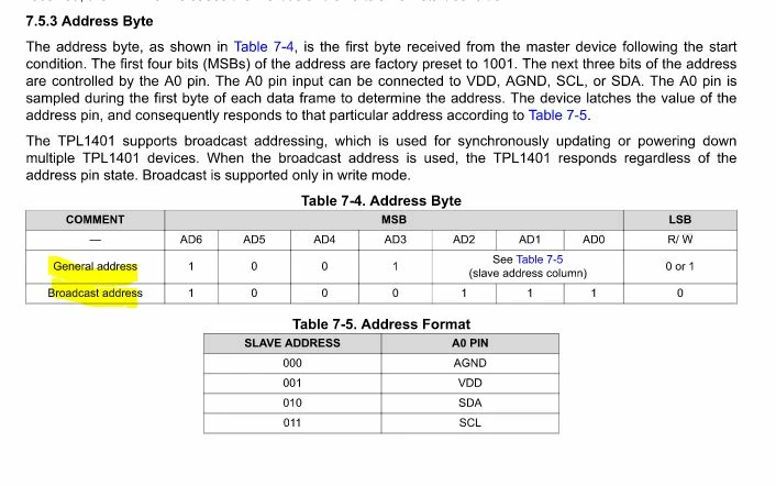

digital potentiometer set via i2c with stm32f303ze
  • January 29, 2021
  • 1 reply
  • 2053 views
I am currently working on controlling a digital potentiometer using i2c with the STM32f303Ze. According to the datasheet of the DigiPot you can send different bits to make adjustments. after a lot of trial and error the voltage still didn't change.
could someone help me look at the code briefly and give me tips
Thanks a lot
1 reply
Vangelis Fortounas
January 29, 2021
Hello
in fuction HAL_I2C_Master_Transmit(&hi2c2, PROTECT << 1, u8_NVMSettings, sizeof(u8_NVMSettings),1000); // General Configurations
second argument is the device address not the register's address
PROTECT register or any other register must contained in fist byte of three bytes array u8_NVMSettings.
u8_NVMSettings[0]=PROTECT;
u8_NVMSettings[1]=value1;
u8_NVMSettings[2]=value2;
device's address is 0x8E (allready shifted broadcast ) or 0x9x (allready shifted ). x is depending from A0 pin connection.
eg HAL_I2C_Master_Transmit(&hi2c2, 0x8E, u8_NVMSettings, 3,1000); // General Configurations
