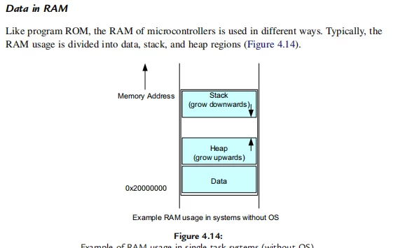

I use IAR to program STM32,the map file shows that :the RAM is divided to​ 1.data Section;2.CSTACK and HEAP section;3.bss section;4.Unassigned part of the RAM。
What I want to know is ​that:The Unassigned part of the RAM is used to do what? Because I want to expand the size of CSTACK ;but I am afraid of that ,too small of the uninitialized memory area size(the size of 4) will cause some wrongs.
Thanks.
    Nothing.
    Your application does not need and use it.
    Declare (and use) more variables, and the size will reduce.
    Too small of a stack will definitely cause you trouble.
    Determining the required stack size is not an exact science, toolchains are often quite bad at it, or forgo it for a fixed value.
    The only additional requirement is, all the mentioned sections must fit into the RAM.
    If not, the linker will tell you.
