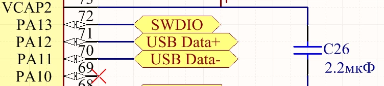

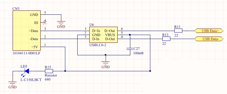

Can't connect STM32F4 via USB to PC

    Use JTAG/SWD and get software on the chip to validate your design. Of specific interest is that the HSE starts, how long it takes to start, and the frequency (output via MCO) is solid.

    You writes software, you JTAG it.
    You validate your design from the inside out.
