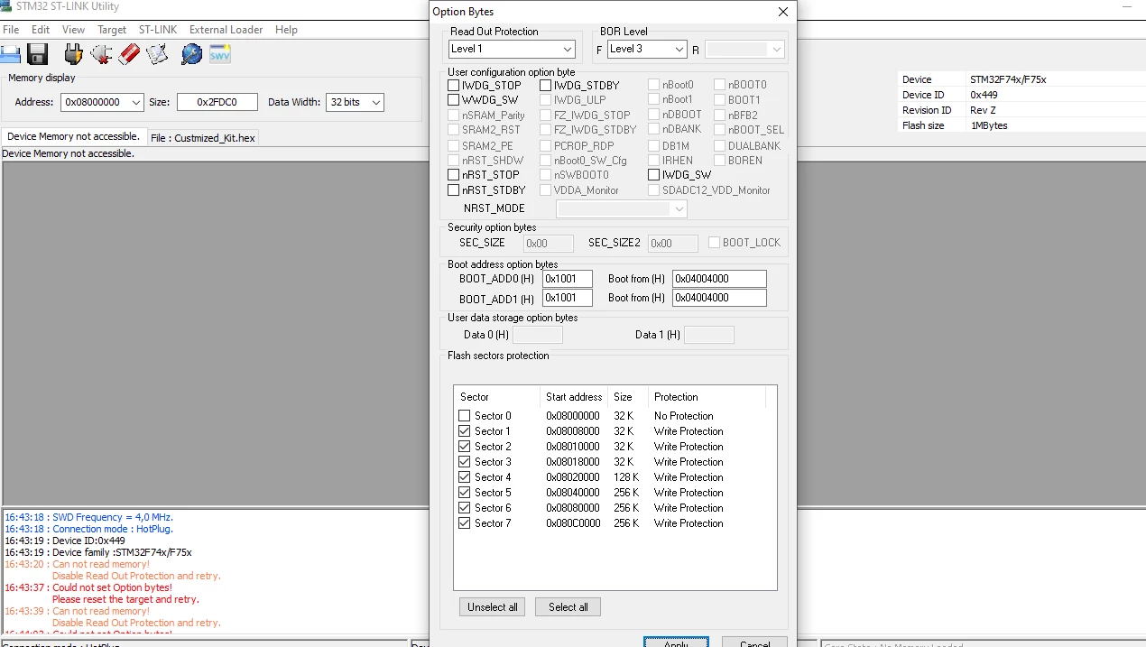

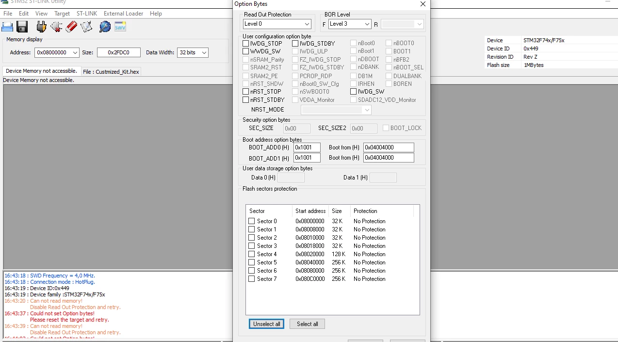

I am using STMF746 controller with my customized board. By mistake I set memory protection unit. When I m trying to connect with STM Utility software, I am getting below error.
Can not read memory!
         Disable Read Out Protection and retry.
In option bytes, I can see below settings
0693W000006EpMPQA0.pngand When I did below settings , click on apply I get error.

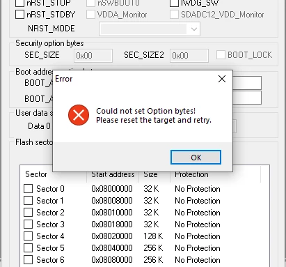

Any help ?

@Community member​  @Community member​ Actually I am programming my bootloader code. Bootloader section is at section 1 so when I program my bootloader, Other section of flash is setting for write protection. I am not sure about reason, Any suggestions?

Yes I grounded reset pin and somehow able to erase my previous code. But Facing same issue when I program same bootloader code.
