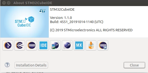

  • CubeIDE v1.1.0

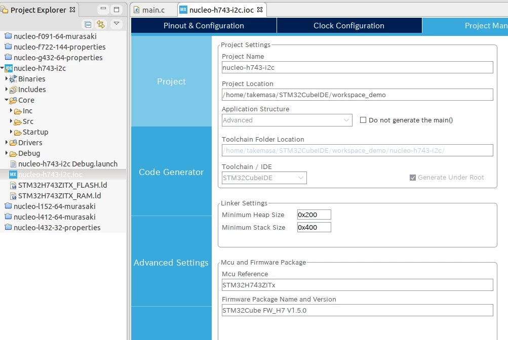

The Cube H7 is v1.5 as you can see in the screenshot.

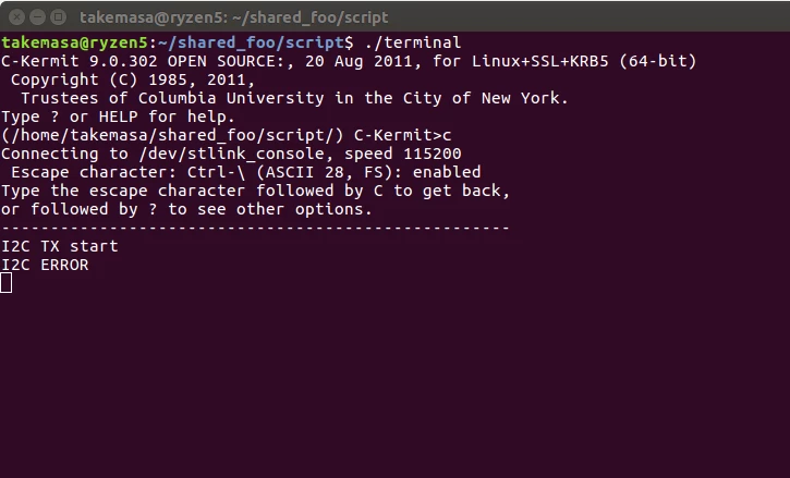

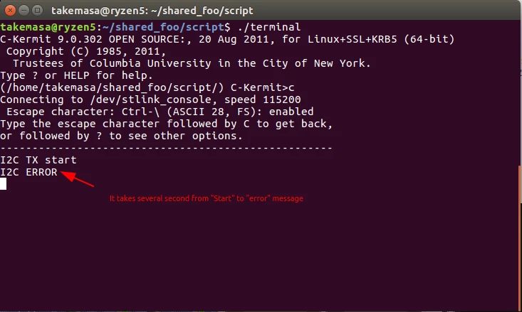

I am afraid you misunderstood how to identify the success / failure of I2C by this demo soft.
  1. You must pull up You must pull up the I2C1 bus (PB8, PB9) correctly, as written in the original report.
  2. I2C peripheral is working correct only when "I2C ERROR" message is displayed right after the start message.
On my Nucleo H743ZI board, this program displays "I2C ERROR" message several seconds after the "I2C TX start" message ( See screenshot ). This is wrong behavior.
