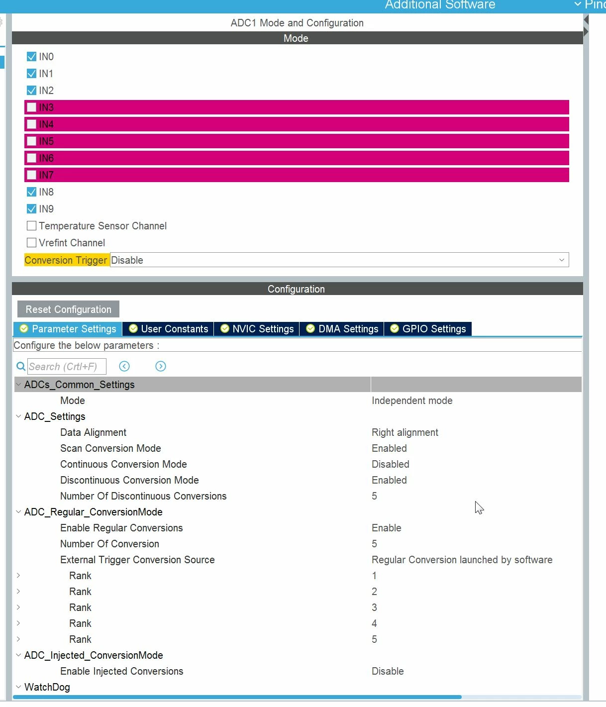

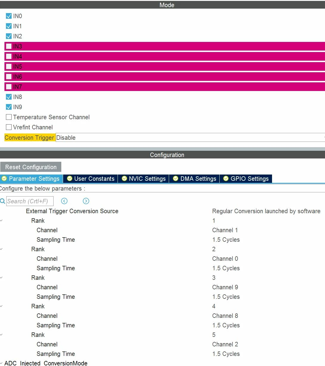

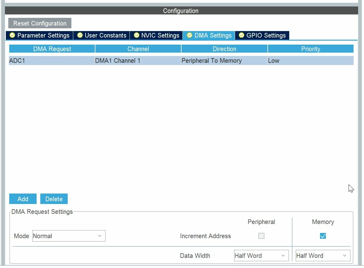

ADC with DMA in discontinuous mode samples first rank twice (STM32F103)
I want to use an ADC with DMA in a STM32F103. I configured it in Cube as you can see in the following picures.
When I start the conversion with
HAL_ADC_Start_DMA(&hadc1,(uint32_t*)AdcData,5);
HAL_ADC_ConvCpltCallback() is called and I see that the AdcData values all changed.
Unfortunately the first rank is sampled twice and the last rank is lost.
I tried to extend the DMA length to 6 but then I do not receive the callback.
I tried to extend the DMA length to 4 but then the last AdcData is unchanged.
Has anybody an idea why this happens and how I can get rid of this?

waclawek.jan
Jul 3, 2020 1:19 PM UTC
Read out and check/post the ADC registers content.

waclawek.jan
Jul 4, 2020 10:26 AM UTC
Discontinuous mode is intended to convert a subgroup of the sequence defined in ADC_SQRx. But you set DISCNUM to the same value as ADC_SQR1.L. That doesn't make sense, so just simply don't set DISCEN.
FDrab.1
FDrab.1Author
Jul 4, 2020 7:41 PM UTC
Hello JW. Thanx for your answer.
Though your answer sounds feasible it doesn't solve my problem.
I set discontinuous mode to "disabled" and regenerated the code.
What I now see is that in the second scan cycle the DMA waits endlessly for data.
I debugged into the HAL and saw, that setting the DMA bit in ADC_CR2 causes the ADC to execute a conversion! This is later the unwanted data..
     /* Enable ADC DMA mode */
     SET_BIT(hadc->Instance->CR2, ADC_CR2_DMA); // line 1643 of \STM32CubeMX\Drivers\STM32F1xx_HAL_Driver\Src\stm32f1xx_hal_adc.c
Stupid question: What functions should I call to use this ADC in a SW triggered sequence mode?
