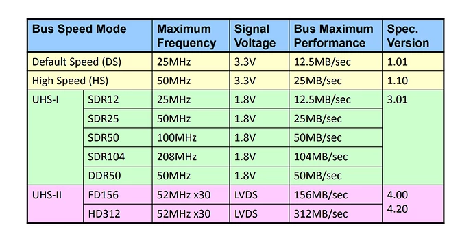

i test SD speed simply with a DSO on data line ; then read a 8 kB data block;
then you see the effective speed (i got about in 1ms for 8kB, so about 8 MB/s with 1bit mode)
and see, is data on line d2 or d3 , to be shure it runs in 4b mode.
+ try different cards ! some are slow or make random delays on command response.
 + without external low voltage driver , speed is limited to 25MB/s with SDHC cards.

All MicroSD cards were supposed to be clockable at 50 MHz, since inception. Likely needs an aware/attentive design on the host side. Certainly a lot that can get into the 60's and beyond without exotic drive modes/levels.
The STM32 typically runs out of bandwidth first.
Writes are usually much slower, due to the need to manage erase blocks, and rotate content.
