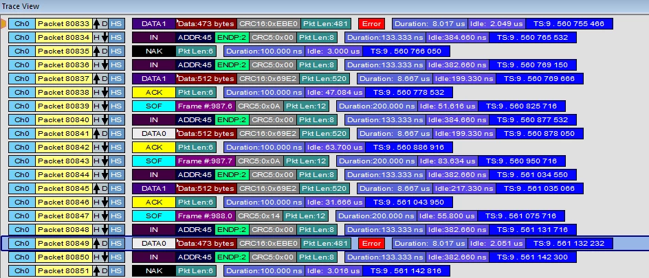

Hello ,
I try to obtain the maximum Transfer-Speed for the STM32 in Device-Mode. I Try to Transfer 15MiB from Device to Host over libusb as fast as possibile.
Every time a ''DataInComplete'' occures, I start another 512-Byte ''DCD_EP_Tx()''-Transfer of generated Data.
My Problem is, that my logic-Analyzer detect every 3 Transfers a Error, probaly because the Data is not complete prebuffered.
What could be the Problem  / What could I try ?
#stm32-ulpi-usb-hs-bulk-libusb #usb #fifo #device

In your trace, two problems are seen,
1) transaction error 2) NAK appears too often
Maybe, it's a problem of endpoint FIFO allocation?

2) NAKs While the device is NAKing, transfer speed drops.
You may pass transfer size greater than 512 (one packet) to DCD_EP_Tx(). For example, 4K bytes or more, as much as your data RAM size allows. In this way, you can reduce the NAK ''gap'' between the transactions.

Thanks,
the Problem is solved. When I use the ''DCD_EP_Tx()'' Function for a larger Block (3*1024) no Errors occur on the Bus.
