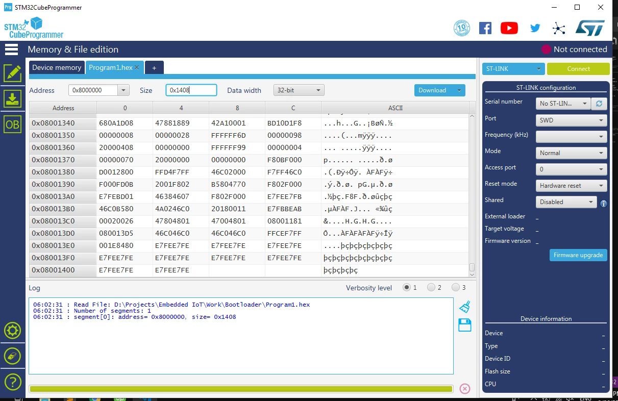

Tesla DeLorean
Guru
March 25, 2019
Why is this such an uphill ski?
:020000040800F2 << SEGMENT ADDRESS INFO
:1000000058330020D5000008C1410008993E00087F << BODY DATA
:1000100000000000000000000000000000000000E0
:100020000000000000000000000000000F47000872
:10003000000000000000000065430008295E000881
:10004000E7000008E7000008BF450008E7000008D7
:1089F0000000000000000000000000000000000077
:108A00000000000000000000000000000000000066
:108A10000000000000000000000000000000000056
:108A20000000000000000000000000000000000046 << END OF BODY DATA
:04000005080000C12E << YOU COULD LOSE THIS 05 RECORD
:00000001FF << THIS 01 RECORD LINE AT THE END OF THE FILE

Tesla DeLorean
Guru
March 26, 2019
They are in ASCII, use notepad or some text editor
JMani.14
March 26, 2019
This is my hex file which is opened in STM32CubeProgrammer.
Could you please let me know where the last line is?
Thank you.
