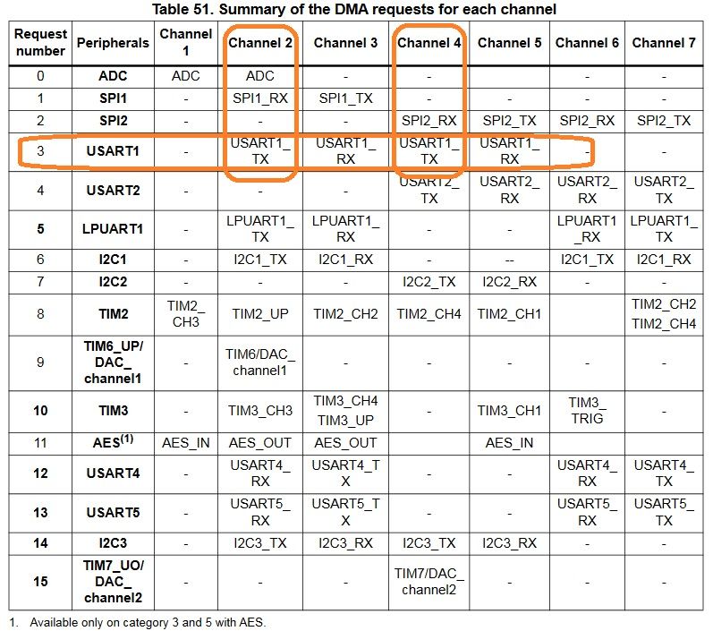

I use the b-l072z-lrwan1 to make lora advertisment and it's work.
I use the project AT_slave or END_Node.
But i want to use the second uart USART1 and nothing work in the environment.
If i just change the file B-L072Z-LRWAN1\Applications\LoRa\End_Node\Core\inc\mlm32l0xx_hw_conf
The program launch but nothing appear on the UART.
I make a project with 2 UART with STM32CubeMX and both work great (it's not a hardware problem)
Someone could help me?
Best answer by Tesla DeLorean
USART1 is REQUEST 3, Channel 2 or 4, check also hard references in VCOM.C
/* Definition for USARTx's DMA */
#define USARTx_TX_DMA_CHANNEL DMA1_Channel7
/* Definition for USARTx's DMA Request */
#define USARTx_TX_DMA_REQUEST DMA_REQUEST_4

Thanks for your reply.
Do you have a link to a doc wich explain these configuration?
What i want is USART1 in standard output
In a second time i want USART2 in TXRX mode without DMA.
USART1 work with channel 4 but not with channel 2
#define USARTx_TX_DMA_CHANNEL       DMA1_Channel4

Thanks for the first correction,
So now, I want my USART1 to work again.
I modify only vcom.c.
 //status = HAL_UART_Init(&UartHandle1);
If i do not init my USART, everything works, otherwise only the first message appear on USART2.
Any idea?

Hi @Community member​ ,
I'm not really happy with my CubeMX project because Lora does not work very well ...
So get back with EndNode project.
Lora is OK
I have TX and RX on UART2 at 115200 !!
But when i tried to initialize USART1
// if(HAL_UART_Init(&huart1) != HAL_OK)
//  /* Initialization Error */
//  Error_Handler();
My USART_2 gState still locked in HAL_UART_STATE_BUSY_TX mode.
I don't understand where the default is.
I only change this comment lign and USART2 stop working.
The DMA not release the gState in READY mode...
Do you have an idea?
MMath.10
MMath.10Author
February 14, 2019
the solution is found :
HAL_UART_MspInit and HAL_UART_MspDeInit shall be separated depending on wich huart called.
