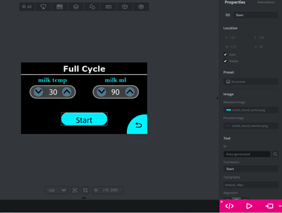

Sanjay27Author
November 25, 2025

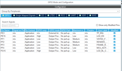

I Configured the Display, but TouchGFX isn't working correctly. The button touches aren't registering properly; they react continuously even before I release them.

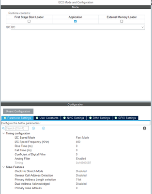

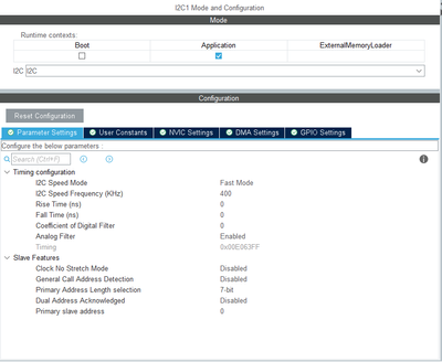

Osman SOYKURT
December 4, 2025

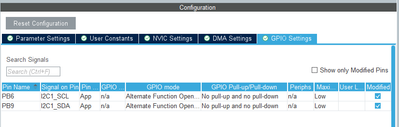

Hello @Sanjay27 ,
Could you check you I2C1 config? Because the sampleTouch function reads touch status from it (at least from our TBS)?You can read more about that in our documentation.
Osman SOYKURTST Software Developer | TouchGFX

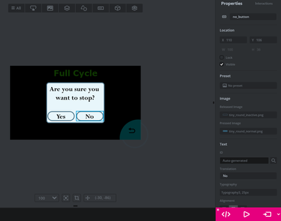

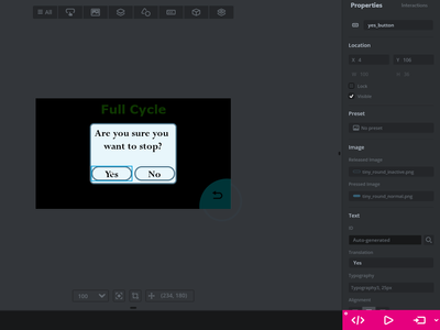

Sanjay27Author
December 15, 2025
Hello @Osman SOYKURT
The Buttons are Reacts before release, see the Pictures and attached video files

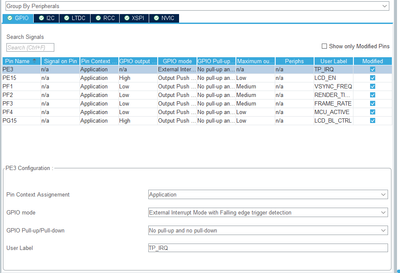

Osman SOYKURT
December 18, 2025
Ok, could you now check your TP_IRQ_Pin configuration on STM32CubeMX ?
You can also check you i2c configuration (I would suggest to make it similar to our current) :
Sanjay27Author
December 18, 2025
My Configurations Still not working well
