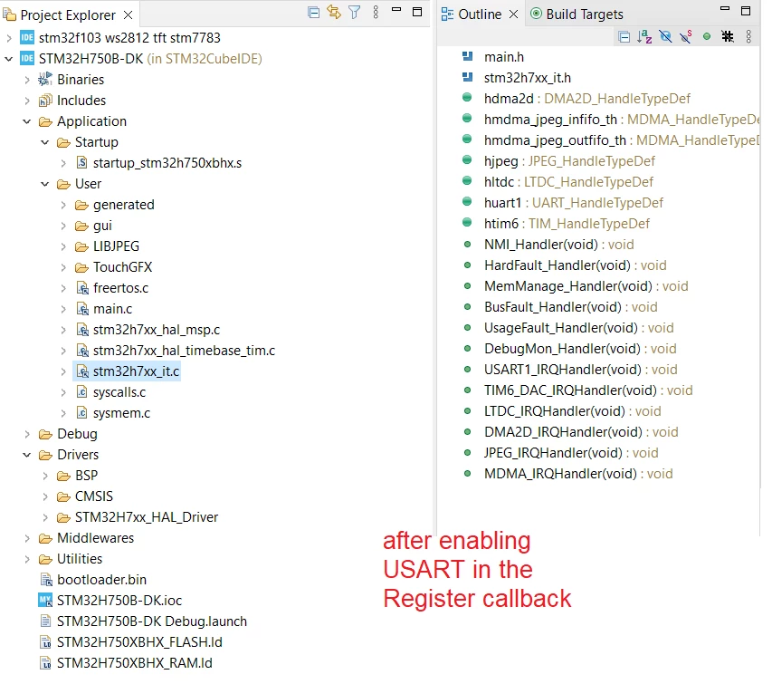

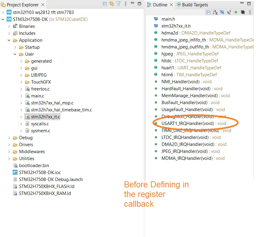

Thank you @Pavel A.​ , please note the below sceenshots
Please note I couldn't locate the file stm32h7xx_hal_conf.h in the project tree. Please advise.
Pavel A.
Jul 6, 2022 5:35 PM UTC
After enabling the callback you still have the USART1_IRQHandler.
The stm32h7xx_hal_conf.h should be in Core/Inc (or maybe generated/Inc for emWin projects). Use dir /s command to find.

Hi @Pavel A.​ , I started the project in TouchGFX designer and it generated the STM32CubeIDE project, and from there I open the cube mx ioc file etc.... As you can see the project tree is not the customary "inc\src" branches. I'll try a simple project and debug through it and come back with my understanding. Thank you.
