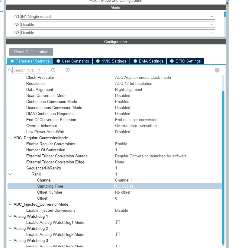

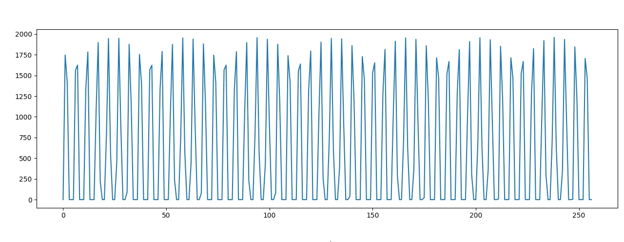

I am trying to sample a 2MHZ sine wave signal at 5.1MHZ adc setting using DMA. But the output of the signal look distorted. ADC clock : 72MHZ I am using stm32f303rE

To me looks reasonable. Your input signal clips at negative, and the "wobble" you see is the effect of limited number of samples per source period.

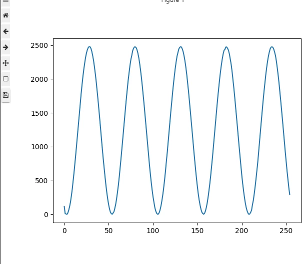

If the source signal frequency(100kHz) is low , the ADC sample then look fine.

Try to sample it at the same sampling frequency ratio, i.e. 100kHz / 2MHz * 5.1Msps = 255ksps.
Patukes
PatukesAuthor
Aug 20, 2021 2:44 PM UTC
There is no change, it is till distorted
waclawek.jan
Aug 20, 2021 3:00 PM UTC
What is still distorted? 100kHz signal sampled with 255ksps?
That's my point, you can't see a "nice" sine if you interpolate only a few points (in your case 2.55 in average) per period.

@Community member​
Thank you, I understand , I have interpolated it and got the proper sine wave. I would rather want to implement dual interleaved mode ADC. Please do you have a sample code for stm32F303RE
