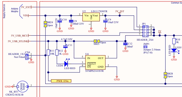

is it safe to interface a WB55 via USB and simultaneously power it via the 5V pin from some external batteries? The battery-voltage I use is limited to 5V. I have some concerns about bricking some electronics due to multiple grounding. Are there some safety measures in place against it?

With multiple power supplies you need to ensure supplies do not power each other. That can be done by using a schottky diode between the supply and the VCC rail, or some other such isolation.
There are no issues with multiple grounds.

What I forgot to mention:grinning_face_with_sweat: I'm using the WB55 on a nucleo board. See the schematic here. It has some diodes on it protecting the 5V pin. Do you think this is sufficient? I'm more of a programmer I can barely read these schematics. I'm surprised I even understand that there are diodes on it. But no schottky diodes I think :thinking_face:.
Which USB ? from st-link usb there is a power switch, to enable/disable connection.
And JP3 is there, to let you connect the source, you want.
"USB and simultaneously power it via the 5V pin " is no good idea , set the jumper on JP3 to the source you use, thats simple and safe.
Why you want "USB and simultaneously power it via the 5V pin " ?
